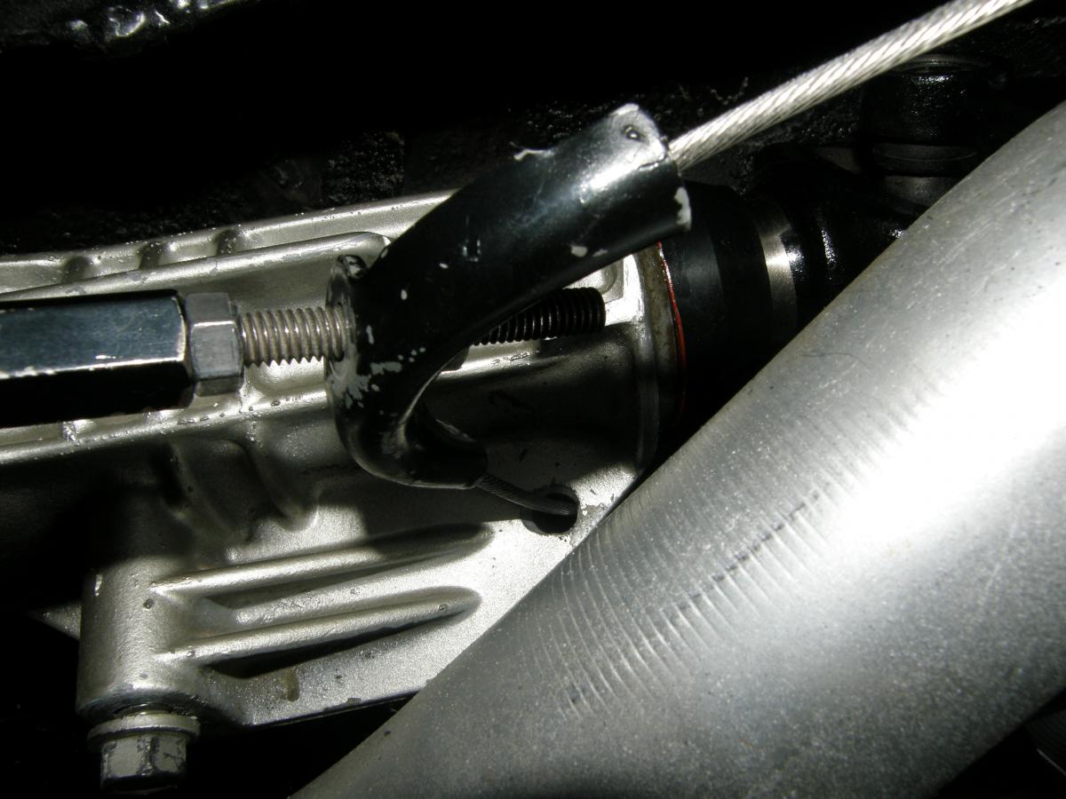

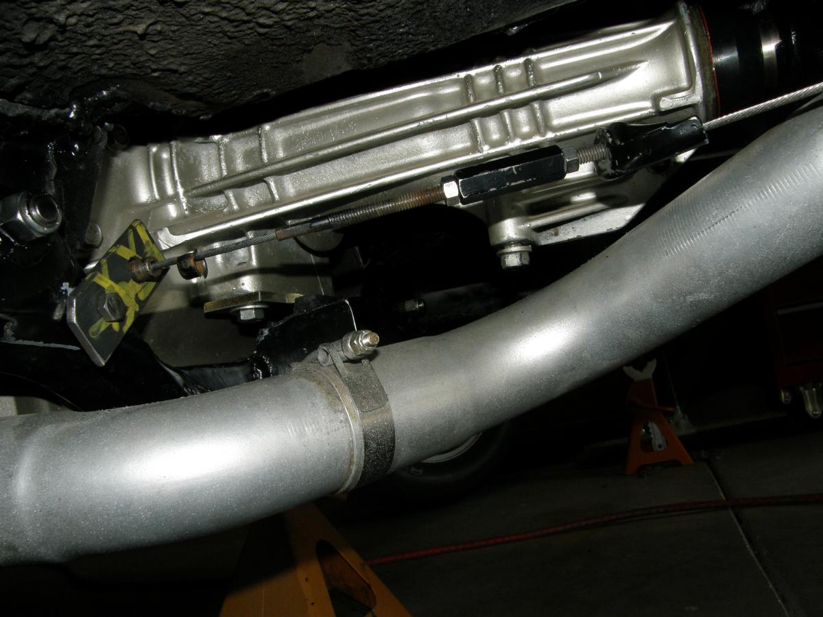

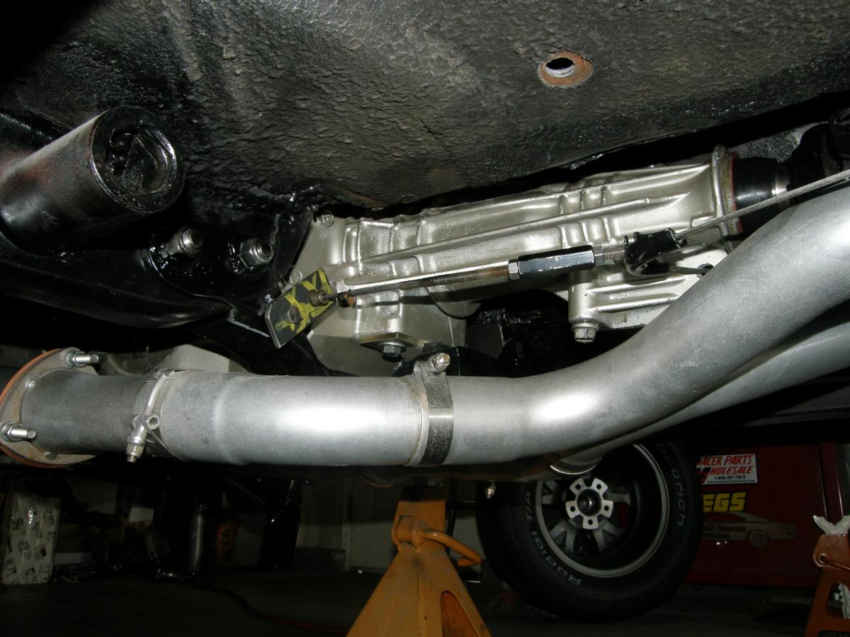

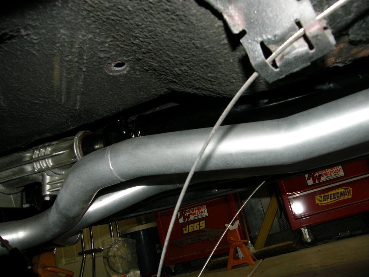

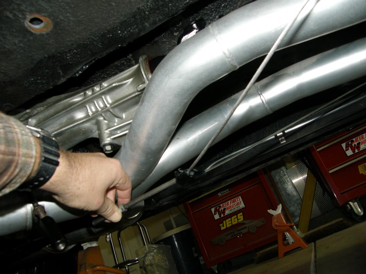

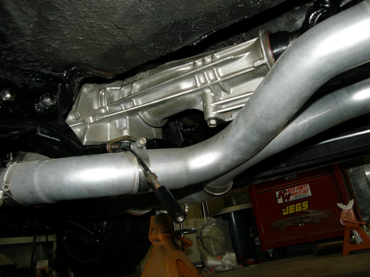

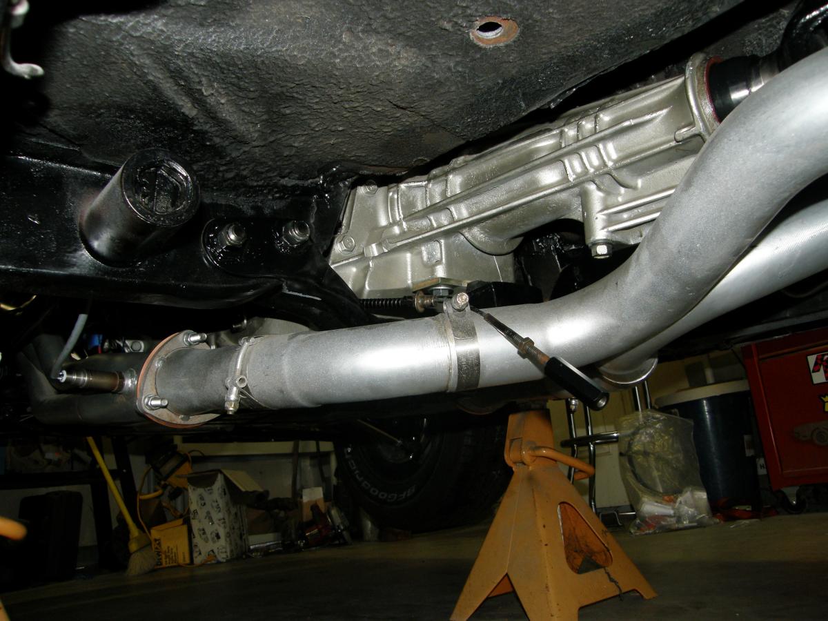

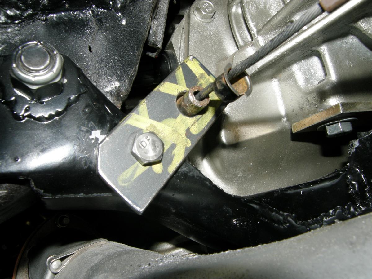

Here is the problem with hooking up the e-brake cables. The x-pipe is in the way and I'm struggling to find a fix for it...wont drive it until I have a working e-brake, and yes, I still have some time before that happens. Also a few of the little elephant just waiting to fire up.

Zack you don't have room to go over the pipes with the cables? You've probably tried every way there is, but just asking.
I'll try it..again, maybe I overlooked or didn't have something right.
Nah, no vacation, just trying to get things in order (household stuff). I got to say this....OLD DUDES ROCK!!! My buddy that used to work with me, now retired for some years, same guy that helped me put the engine/trans/suspension back in, came over today and fixed my e-brake problem. I tell ya, you will learn alot of stuff from the been there, done figured it out older guys. Within 5 minutes he figured out the problem, had me make a new bracket out of steel (used aluminum prior), and put it all together and I had a working e-brake. So to all you older guys out there, my hat is off to ya!!!

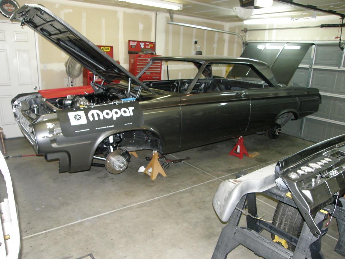

Here is what the e-brake looks like now, it works, and yes I got to tear it apart for the cable grommet and do some trimming and paint on the exposed metal. Also thought I would include a shot of how it's sitting...just some eye candy.
