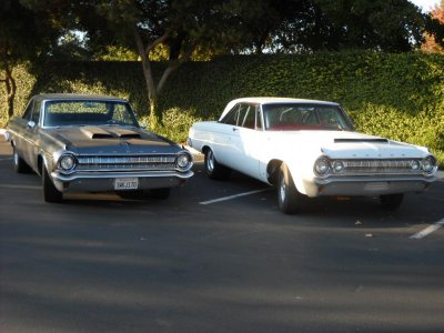

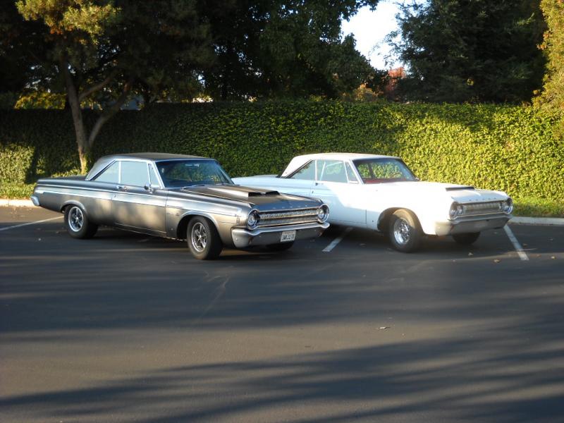

I saw a pic of your car you have posted on a "Show us some pics" thread. Why haven't you posted a "done" pic on this thread yet?????
The one I saw was of the car in your driveway.
Time for a "Beauty shot" Bro!

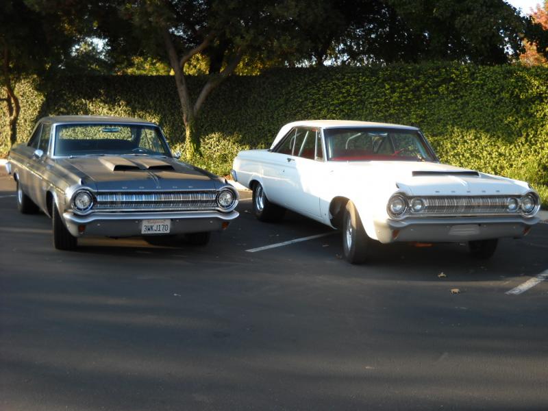

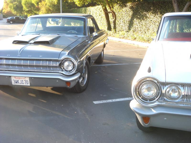

Well Darius the car isn't quite finished. It's drivable, but still has some bugs to work out. A beauty is shot (tires up in smoke) is coming as soon as I can. Might get a 6.1 intake manifold, but not sure as of yet.
Zack drove it up a few weeks ago. Took me for a ride. Runs Great!! Looks Awesome!!!

Hey, hey, hey, yours is friggin' bitchin' too. Them huge *** big meats are cool!! It was nice to get the compliments at the gas station.
