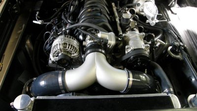

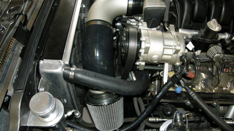

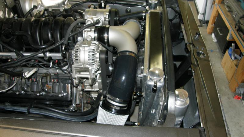

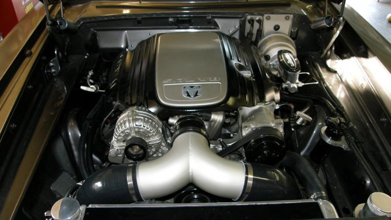

Some eye candy for you guys......dual inlet air intake is 4 inch diameter.

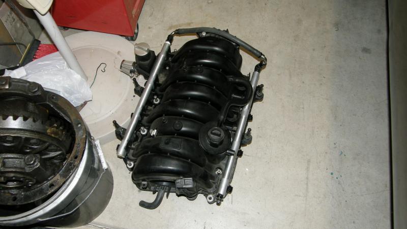

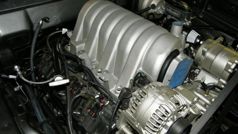

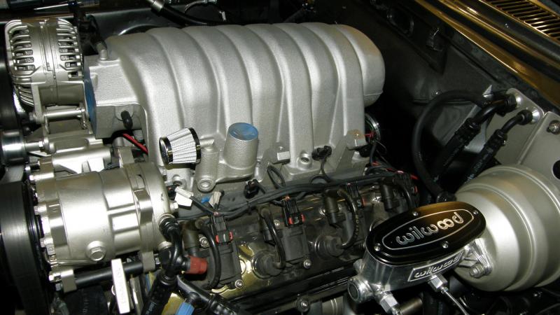

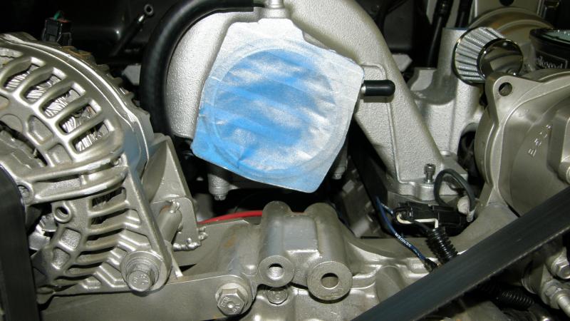

Just got my 6.1 hemi intake manifold, it's flippin' heavy, and started the painting process and ran out...that bites!! This is gonna be fun, and I'll need to port match my spacers to the 6.1 ports and then blend them.
Still waiting on the paint to get mixed, man they are slooowww!! Anyway, here's some shots of the new stuff, enjoy... also there is the lx manifold, and you can see why the spacers are used to clear the top of the timing cover, hell I may just mill it down and would not need to use the spacers.

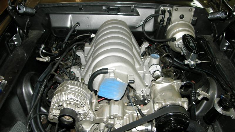

I got the 6.1 intake on and it's oh so sexy. Also bought a set of used heads that will be gone through and port matched to the intake manifold.
