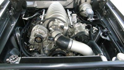

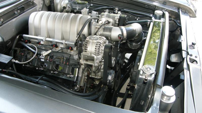

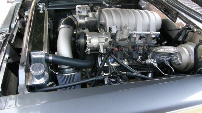

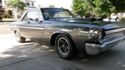

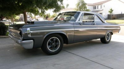

Eye candy
Enjoy!!!
Lookin' good Zack.....:headbang:
