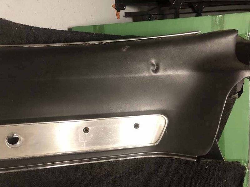

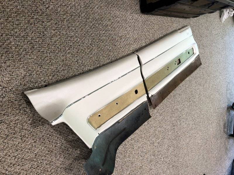

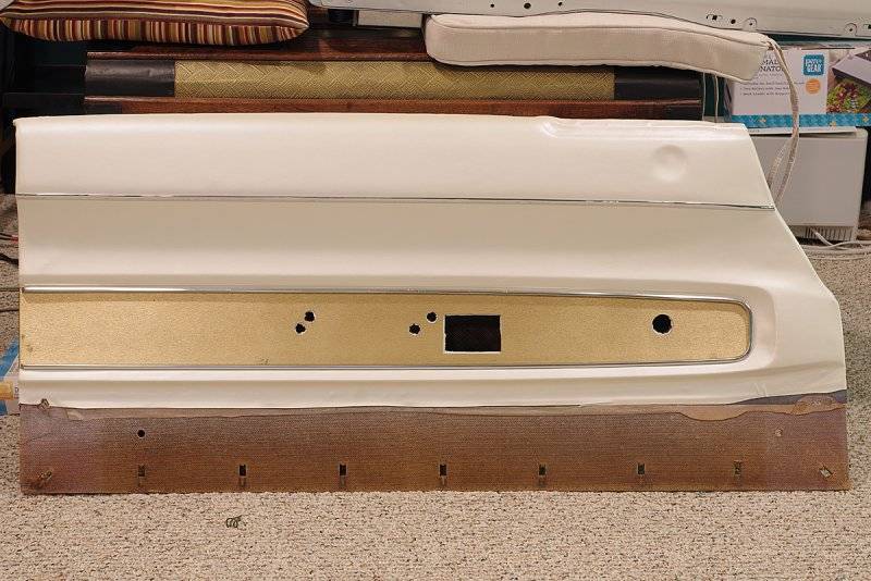

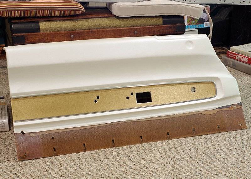

Took a break from a few my other tasks this afternoon, and recovered one of the rear panels. I still have to apply the Pearl and add the trim, but it turned out well enough for me. This panel use to have a big silver dollar size crater in it about 1/2" deep, but I made repairs in that area before recovering.

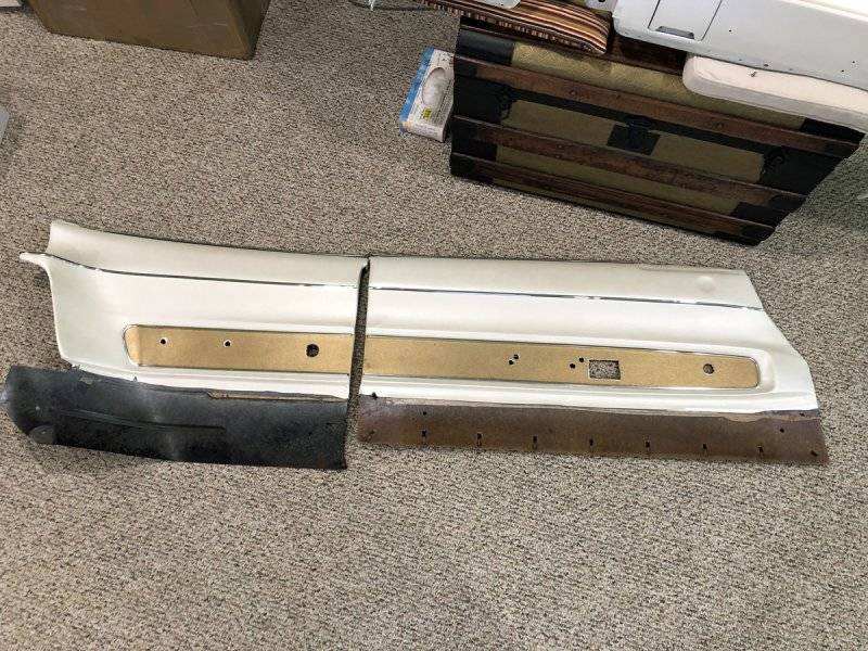

Finished up that rear panel this morning. One side of the car down, one to go.

I’m not familiar with 67 chargers, what’s this part on the door panels? I noticed they didn’t get recovered.
Ayuh... That's correct! Each Panel gets a section of carpet at the bottom. I'll be putting those carpet pieces on once I have all 4 panels done.

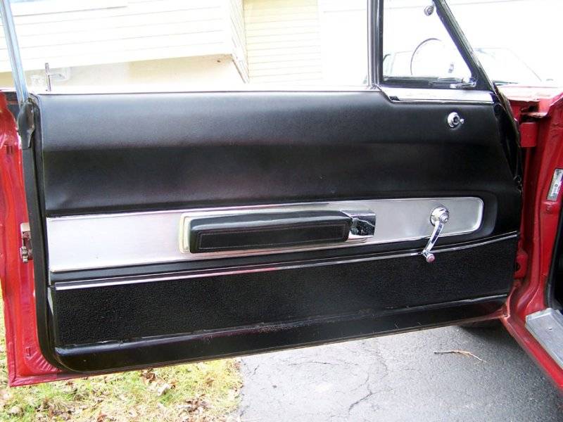

Here's a shot of my original door panel with the carpet in place. The new carpet will be a medium saddle brown color now however.

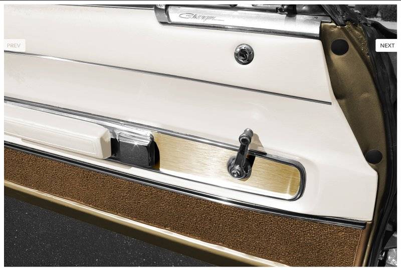

Here's a Photoshop I did illustrating the new look of the panel when finished.

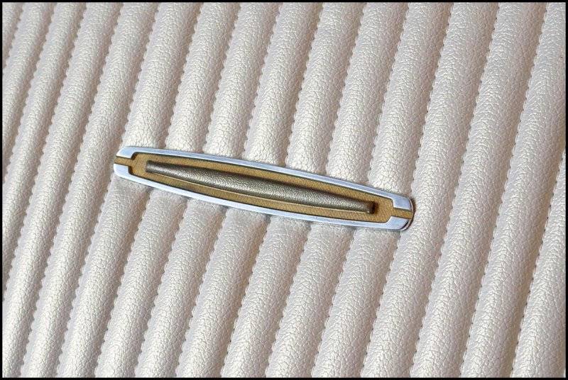

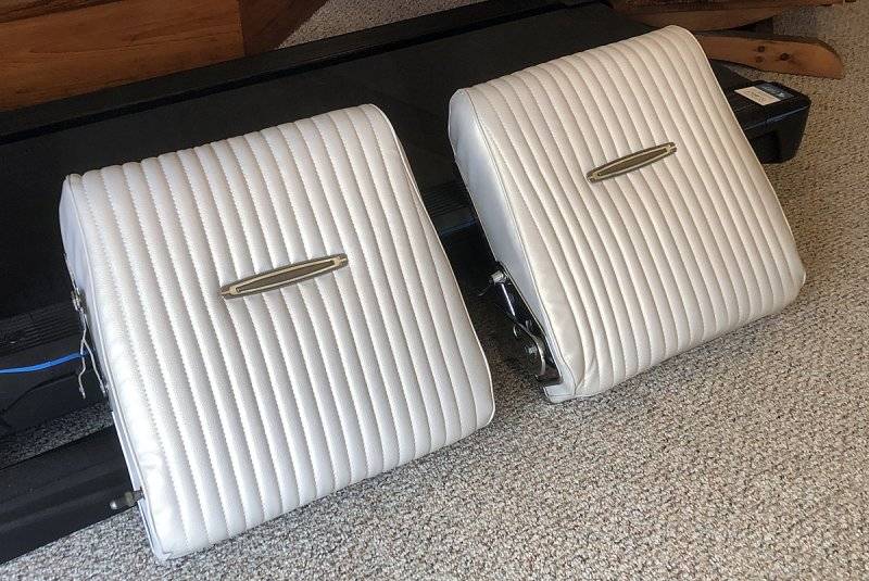

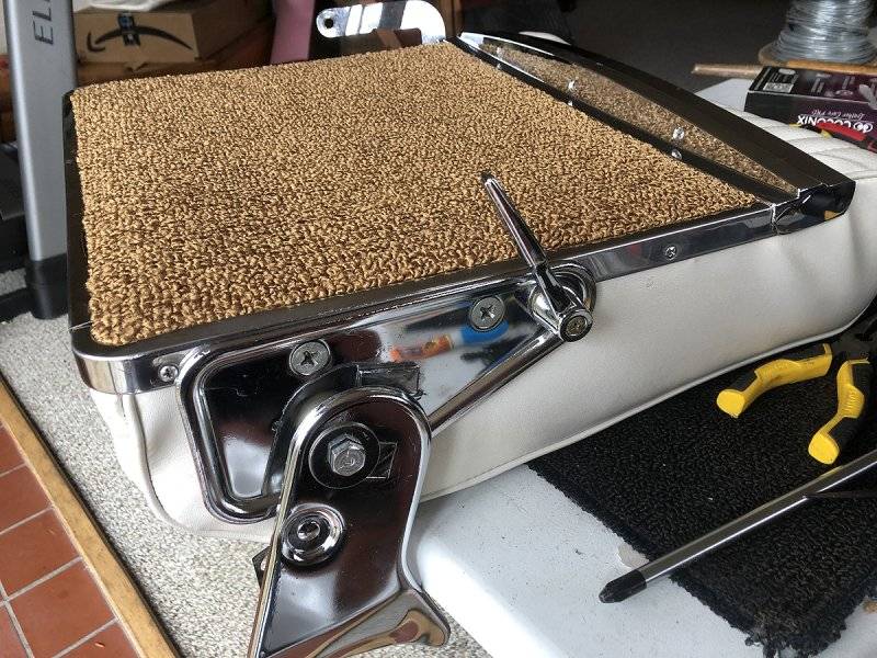

Some of the other interior parts have been done as well, like the rear seats for instance, all recovered and ready. Still waiting on new covers for the front though.
These use to be Black with Black seat medallions

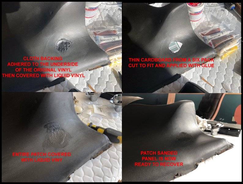

For the vinyl repairs, I used cloth and a vinyl repair kit. Another incredibly tedious job, especially when doing large fills like I had to do. It can take several days in some cases. Both rear panels were damaged, as well as the center armrests. In fact there was almost nothing that didn't need to be touched up or repaired for the interior restoration. Example: both of the rear sail panel covers had broken, important attachment points broken off. The rear seats had caught on fire at some point in the past (lit cigarettes dropped under the seats). The foam was all burnt up and destroyed, but no one bothered to fix it, they just put new covers over the farg'n mess and damage. That said I had to make repairs, replacing the damaged foam with new stuff shaped to match the original (rear seat foams are not available for this car, only fronts). I spent months repairing everything, but it's all coming together now though.

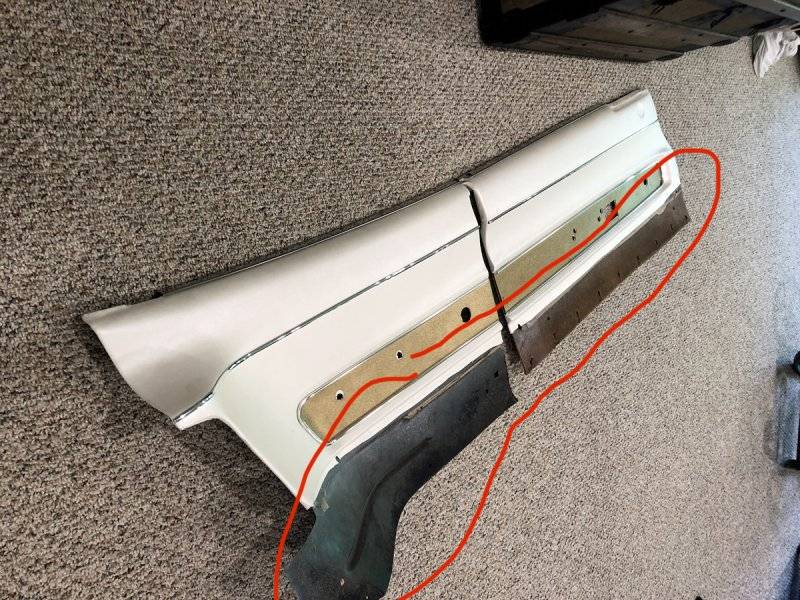

Here's a shot of the damaged rear passenger side panel before making the necessary repairs, and another shot is of the drivers side panel being repaired. The drivers side was just old and cracked however, so it was a fairly simple fix... it only took 3 days for that one.

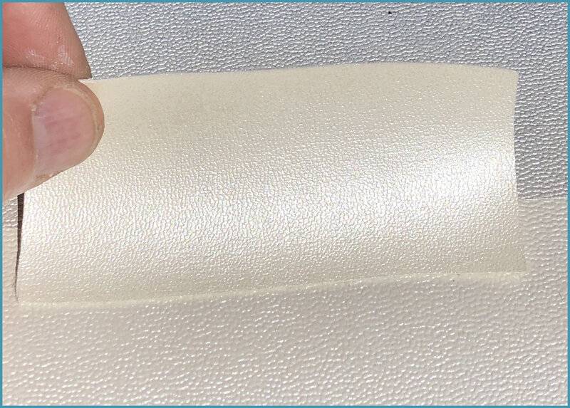

SEM Products... Soaps & Preps, followed by SEM Mystic White for a base to cover the black. Then SEM Ranger White for the final Off White tone needed. I am recovering the original black interior door panels with an Off White vinyl, so I needed to match the color of that vinyl as close as possible. After that everything gets dusted with Pearl from Herbs, which is the same as OER.
I personally like the Pearl from Yearone the best, but they couldn't supply me with the quantity I needed at the time.
This is a shot of the Off White vinyl held against one of the painted plastic interior pieces. They were each dusted with pearl for an even comparison.
The silvery white seen in the background on this test panel is the Mystic White base color.

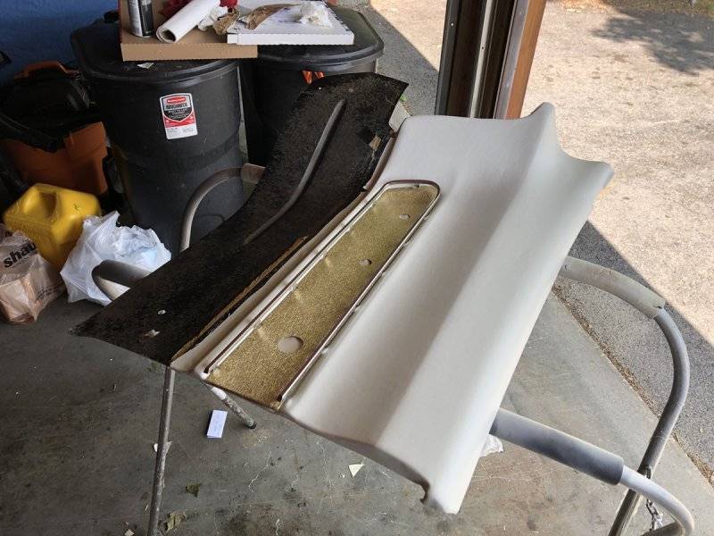

Started working on recovering the old black interior panels to match the new interior. I've only started the one at the moment.
Never done this before, so I'm being cautious, taking my time, so as not to screw it up to bad. :lol:
