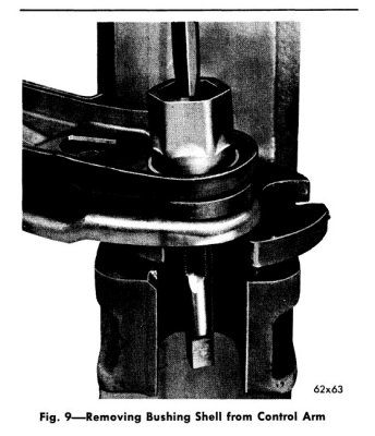

Looks like you are working on a '66 Coronet? In my '62 Dart service manual it says to use a large tap to thread into the outer shell of the LCA bushing and then press it out. I bought a used tap off eBay and plan to go that route, rather than cutting it out and risking damaging the LCA.

So, the part that Juergen is referring to is just some extra beef on the LCA, right. A lip, a place for the outer shell of the bushing to hold on to. Otherwise it would only be the thickness of the LCA's stamped steel and bend all to Hell when you tried to press the bushing in. How do you make that outer sleeve go away? Drive it out? Sawzall?

Yep, correct it's a lip stamped in the LCA. I never had to remove mine as I used poly bushings . Various ways to remove the shell, press it out or chisel and hammer to collapse it then pull it out etc...
