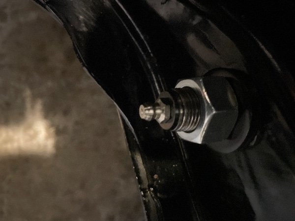

Proforge greasable pivot, poly LCA bushing, and with weight of car (with engine) on front suspension, provided pivot lock nut spinning pivot prohibiting torque to 130lb/ft. Any advice appreciated.
Hmm. May have to back the bars out, pull the arms out, pull bushings off the shaft, get something latched onto the shaft to stop rotation, the torque it. Relaod the components. Great question as I have the Delrin units for my 65 and will need to do this in the future too.
Thanks ckessel. Provided proforged lock nut was threading on incorrectly. Was able to remove junk nut and repair threads as best possible. Now have a non lock nut on and thinking I’ll go with a lock washer or a nyloc

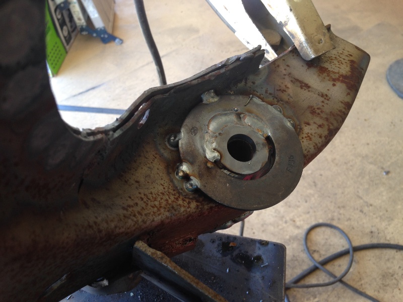

My stuff is from Firm Feel. Bought it many years ago, but have not used it yet. Would have been a pisser to get everything loaded in just to have to take it all back apart. Your question saved me from an oh poo episode like what you found out. Looking at your picture, I used that thick washer under the nut as the first ring of reinforcement on the 70 K I worked over for the 65. Found a structural flat washer that fit around the outside of it for more bite.

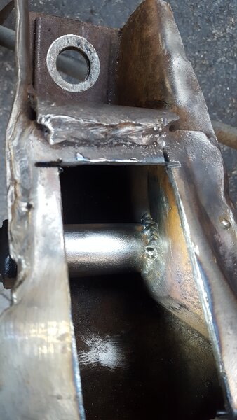

On my 67 I also cut a hole in the k-frame in order to weld the front of the LCA pivot shaft to the k-frame, it's only welded to the k-frame on the rear, and you cannot weld the front from the outside.
Maybe if you cut the pivot shaft opening wider, making sure not to mess up the shaft sleeves.

I welded it up on the inside now the LCA mounting is secure front and rear.

It's the other side that is hanging free inside the k-frame, not welded to anything.
For the 70 unit I'm using for my 65, I cut windows in too like you did.

After disabling the suspension and reading the SM on how to reinstall it, I assumed it was the weight of the car on the suspension that kept the pivot shaft from turning while tightening the nut. Once I got the threads repaired on the DVR side pivot and purchased new nylock nuts I was able to tighten to 130ftlbs:)
I cut access ports on the K to get at the backside of the tubes. Couldn't weld all around, but did pretty decent. Had to do some scrubbing to get the rust away before hitting the tubes with the gun. No reinforcements on the backside other than weld. Outside, yes. On my wagon and the Challenger I'm working on, I did put a light film of antisieze on the shaft where it expands to mate to the tubes. Threads too. The wagon got a minor amount of reinforcement around the tubes on the outside like I did for the 65. Big, structural steel flat washers. Tacked and then formed over the K, then welded all around and to the tubes.
are you reinforcement welding the pivot shaft sleeve inside the k-member box? And, doing so aides in keeping the pivot shaft from turning inside the k-member and bushing when installed and torquing the nut to spec?
Yes on the inside.
I did it because there's nothing supporting the sleeve in the front.
