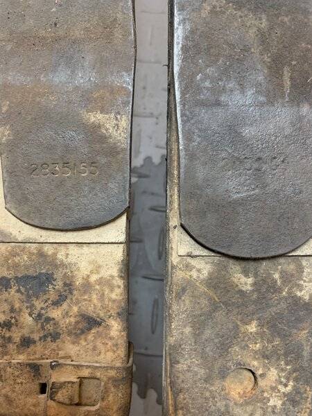

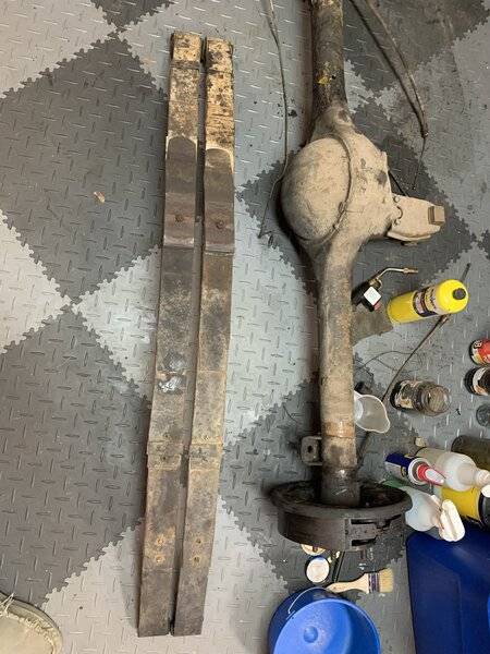

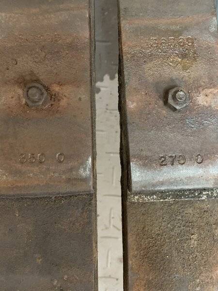

I’m 98% sure I know which one is driver’s side and passenger side, but does it matter? They look the same except some overspray and stamped numbers. Can the numbers identify them?
I’ll keep them apart when taking them apart! Thanks

Passenger side has more leafs than drivers side.
Here's a good video explaining why:
Makes sense, and thanks for the video. I subscribe to his show, and like the ones where he shows misrepresented cars for sale!
I’ve got five leaves on each set. They look like clones. No idea what the previous owners did...
