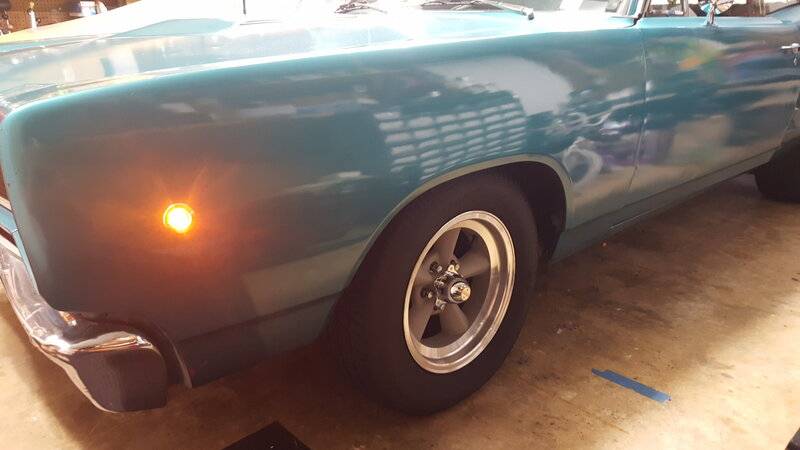

Has anyone changed out their #57 bulb side marker lights on a 68 or 69 coronet with LED's ? if so what brand and number bulb did you use
Don’t have the numbers right here, but go to super bright led.com and plug your car in. It will give you every bulb. I am running 100% led in a 68 Coronet. You may need to look at flashers depending on how much you change. You will need the one with external ground and the reverse polarity option.
I have on my coronet and dart. The only exterior bulbs are the headlamps but they are on relays. BA9S from superbrightleds.com is what I use from the side markers. Amber front, red rear of course. Rear 1156's are from westcoastclassiccougar.com, I like their red "plasma" led's the best for the rear tail/brake/turns ...
.. also running a no load flasher, no external ground..just plug it in and go!
