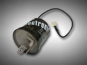

This one flasher is all you'll need to make the signals work
just like hyrdgoon said this is what i used with my digi-tails and work perfect.........
