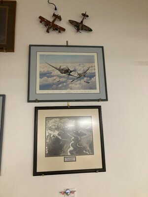

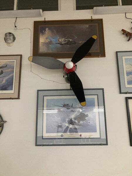

I rented the lift again yesterday. We got all of the pictures/signs/models etc on the west wall now. My wife came up with the bitchin idea to make paper templates of the picture/sign layouts ahead of time. Those got put up and from there I punched holes. If she hadn't been involved in this it would have been just helter skelter on the layout from me. There are times for Fung Shui! When I did the pictures, I leveled them up then marked with some tape on the bottom. Pulled the picture back off, put some L brackets under that are 1/2" up from the mark. This takes some of the tension off the hanging wire on the back side. When in place, I put one bracket hanging over the top to catch it in case of wire breaking or quake. When I lifted off the Spitfire picture for the lower brackets, the wire broke. Luckily I didn't drop it. Pulled the wire out and replaced it with nylon string line like what's used for construction layout. Since its the biggest one and has the nylon, I put two brackets on the top to secure it. That turkey is like 16' up the wall and want it to stay there. I figured it would take me maybe 3-4 hours to get it all done. Hah! 9 hours later it was. The fan was a pistol to get secured onto its mount but all good now. On the 7th the floor guy is coming to prep for the epoxy. After that I need to move the 65 over to the stall so its out of the way for the paver contractor. Getting close!

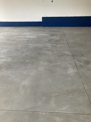

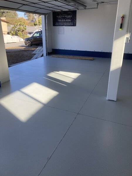

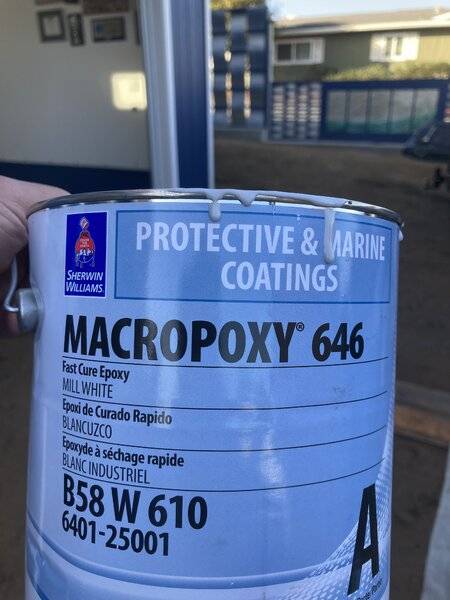

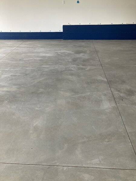

The contractor thats doing the floor told me the straight epoxy would be my best best for durability and fixes. Less hassle without the grind too. He does the Euro car dealerships in the area. Said they typically get 7 years before its redo time. As for the clear, the stuff he uses is water base. Takes more cure time and not as tough. Probably due to California compliance. The epoxy is high solids solvent base. He'll acid wash it prior to coating. Its clean, no oil as no vehicles have been in it other than that truck. It didn't mark its spot. What was that garage forum you mentioned?

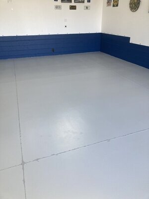

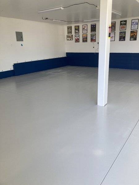

The epoxy started going down today. 2nd coat tomorrow. Have to let it sit for a few days. Sometime after Monday I will get the 65 moved to its new home and start clearing out the other garage of the easily moved items to the new one. Some of it will stay there but need to move all from one to the other to make way for drywalling. I partially disassembled the swing chair to move it and now have it on the topside deck. The paver contractor comes by tomorrow to walk the job and give me a timeframe for starting the project. When the pavers get put down, I can then move the heavy stuff over from the old to new. Toolbox, compressor, bolt bin, safes etc. Kind of hard to get that stuff through the soft sand.

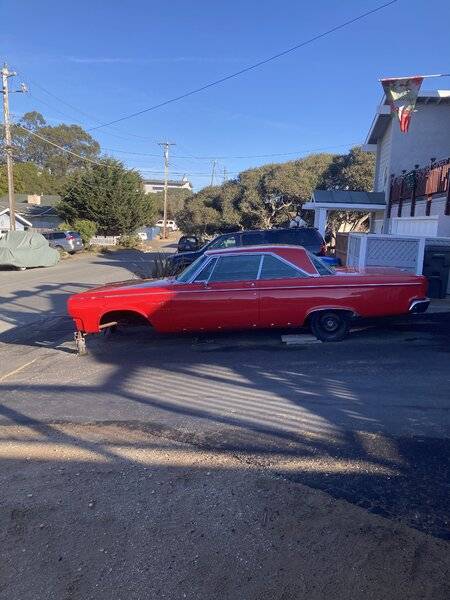

Second coat of epoxy went down on Friday. Sunday I put the Sika self leveling urethane into the relief cuts I made from last year. Its been off gassing with the doors open part way so its fine now. Got the car uncovered, been 2 years, then gave it a bath so its ready for its new home. Just waiting to hear from the tow guy about when he can come over with the slip bed to move it.

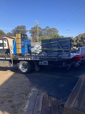

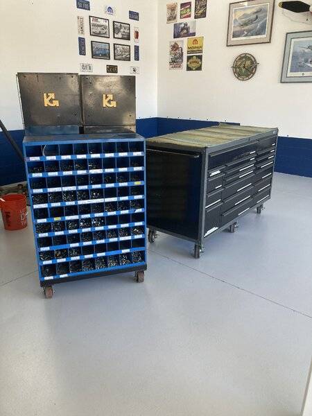

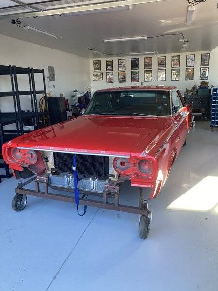

The car is home finally. The tow guys also moved my bolt bin cart and the toolbox. Still have to get the compressor and safe in there but those will happen after the pavers get put in. Since both are not mobile and the compressor is top heavy, those I'll do with my appliance dolly and extra help to keep it from flopping over.

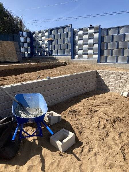

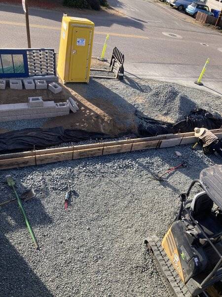

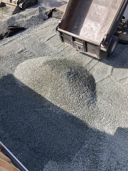

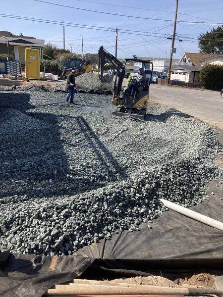

Just realized I had a brain fart by forgetting about posting updates. Last week the sand[ this area is a big sand dune] work, block work and paver job got started. Block walls in the back are close to getting done. They removed a large amount of sand from the front area to prep for pavers. Due to the square footage of the pavers plus county requirements for controlling storm run off, the pavers had to be done in the permeable type. This required digging down 24"+ and backfilling with a huge amount of rock. Big stuff down first, 1 1/2" at 8" or so of depth then about the same of 3/4". There is a concrete curb that wraps around the outer perimeter. This type of paver allows the rain to just go between the joints and through the paver too. The joints get filled with pea gravel instead of sand. Next week the concrete curb gets poured and the pavers get started plus get the walls wrapped up.
