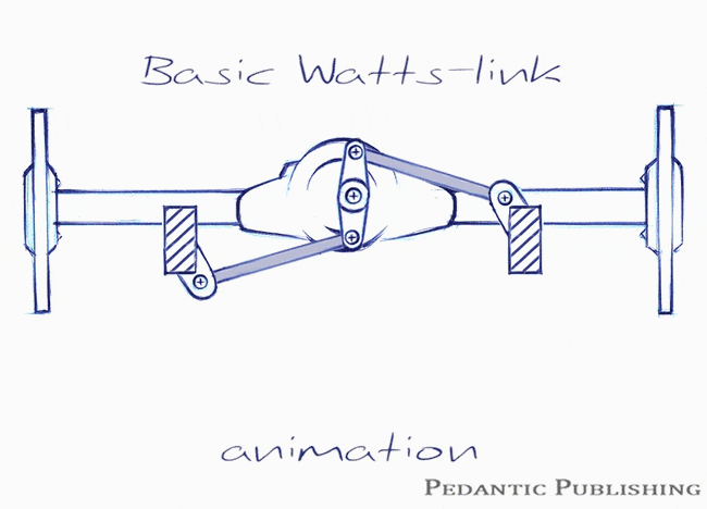

Panhard bar will drag the tires as suspension goes through travel. The longer the panhard bar the better it is, I would not use a panhard bar on a big tire narrow rear axle where you have no room for a long one. Diagonal link is the easy and most common way to go, only drawback is ground clearance on the street, drag cars this is usually not a problem. Watts link is the best way to go, keeps axle in line regardless of suspension travel and gives good ground clearance, sometimes hard to find room under a stockbody vehicle.

We used a Watts Link set up
on the tube chassis. A LPW
diff cover had enough
material where it could be
drilled and tapped to mount
the bars.

8-1/4. The Watts Link also
helps to stabilize the pinion
angle under hard
acceleration, and the LPW
diff cover has bearing cap
reinforcing bolts.

The links use the same
rubber as the 4-link bars.
The Watts Link bars
help to reduce axle housing
rotation as well as keeping
the housing centered.

I wonder why only the animation on a Watts and not include a Panhard bar?
Do I detect a hint of graphical bias here in this debate? :lol:
