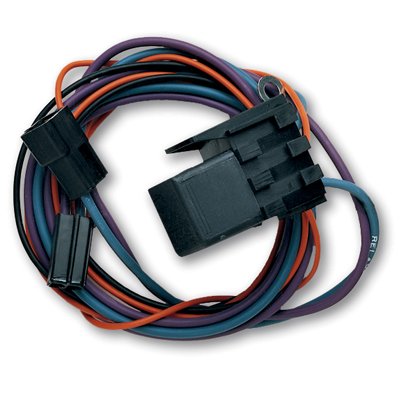

AT-70-Md.jpgI saw this on Ron Francis's website. You could use you hazards, wipers, a switch, whatever without loosing it's function. Sorry it didn't bring up the part number, just look under relays on they're sight. You could easily do this yourself but it is a good idea.

View attachment 103444I saw this on Ron Francis's website. You could use you hazards, wipers, a switch, whatever without loosing it's function. Sorry it didn't bring up the part number, just look under relays on they're sight. You could easily do this yourself but it is a good idea.
Wow, lots of great ideas! 747, that might take the cake though, thanks for the info.
