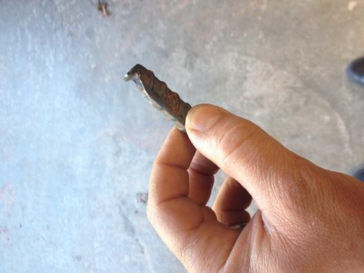

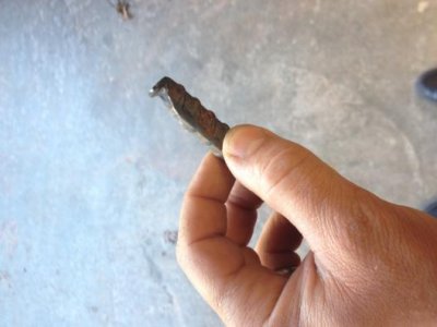

Here's another dandy I came up with after a rash of cursing... front and rear trans seal puller offer courtesy of a piece of rebar and a few minutes on a bench grinder.
On the front, work it around the seal between seal and shaft kinda like a can opener and the seal just pops right off. The rear might have worked great too with the rear shaft still in place, but it worked well enough without.

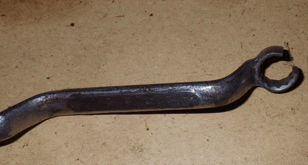

The old 7/16" header bolt wrench.

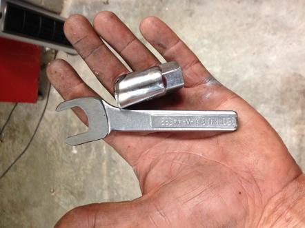

Alternator pulley adapter made from a couple scrap PM punch clamp rings. Enabled use of my 3 jaw puller.

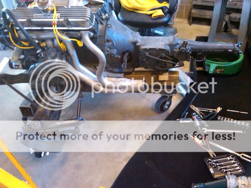

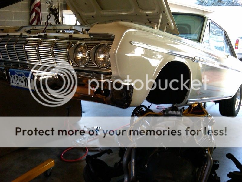

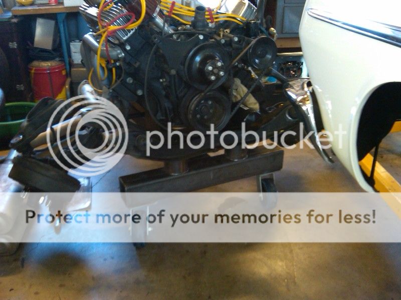

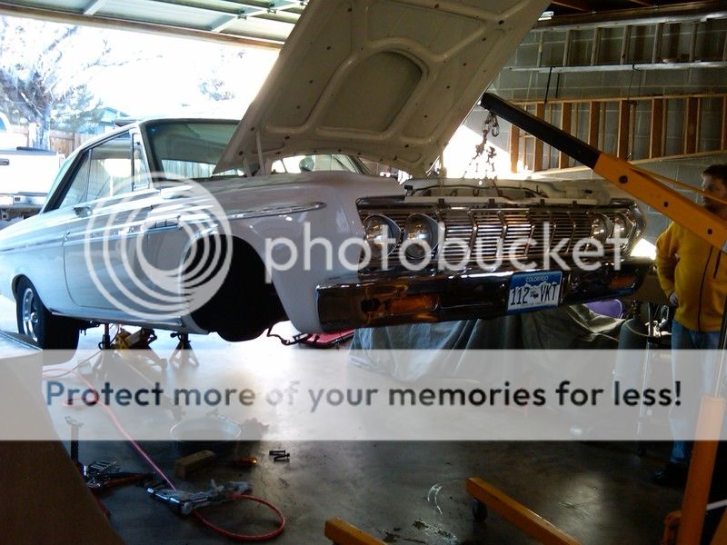

Hey 64post, what does the front of your dolly look like without the engine? I need to make something like that for when I drop out the innards on my 65.
Hey great idea! A modified engine stand could work....
Not exactly a tool, but it's indispensable to me when pulling engines...
What the hell do you mean "not exactly a tool"??, that's exactly what it is and a fine one at that.

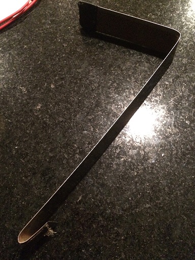

Here is my window fuzzie remover, made from a metal ruler. Prevents paint chipping. The business end is at the bottom.
