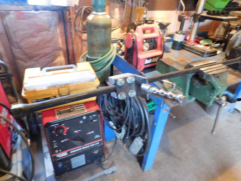

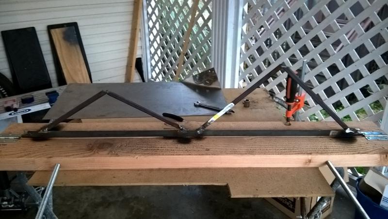

I wanted to see if I could make a cheap way to bend some relatively thin metal. Has 1/2 bolts on the right and left to tighten the bar down to the metal to be bent. This works for me and I plan to make a beefier version for thicker gauge stuff.

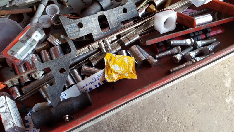

I just found this one.

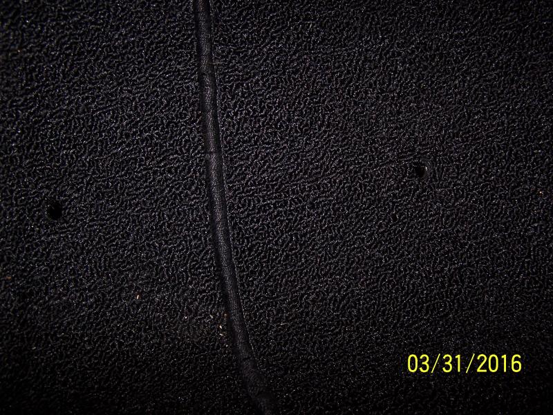

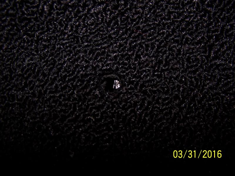

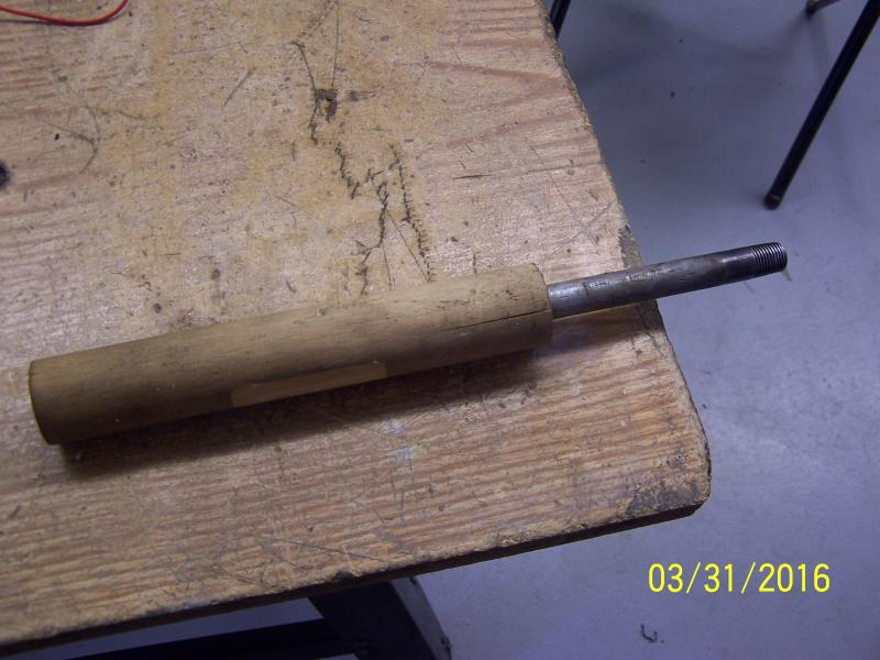

Here is one I made years ago but just used again today. New carpet in my Charger. I learned a long time ago that drilling a hole in carpeting is fools play. I made a tool to punch holes in the carpet for seat bolts and seat belt anchors. I took a 6" length of 1/4" pipe and inserted it in a 1" dowel to keep from burning my hand. I then insert a scratch awl up through the floor through the carpet where I want the hole. Then heat the end of the pipe with a benz-o-matic torch. Slide it down over the awl and presto..........nice round hole that melts the carpet fibers so there is no guessing where the hole goes. Melted right through the sound deadener too!

Brilliant.
I need to make one of these I hate installing new carpet just because of the hole hunt

Talk about a cool tool.
That thing is worthy of chrome plating the pipe and making the handle out of fine finished walnut.
Well done sir.

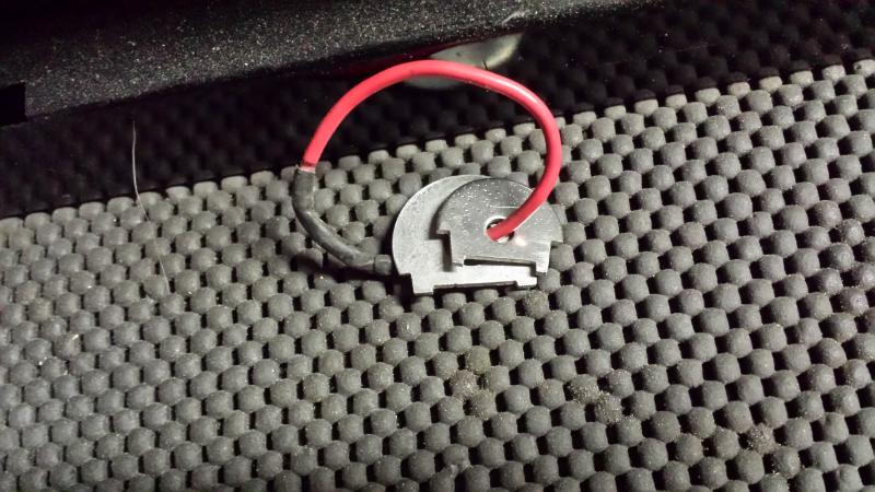

Here are a couple dash bezel keys I made for my 1962 Belvedere. Both are made out of large washers filed down to fit.

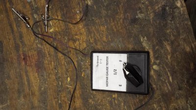

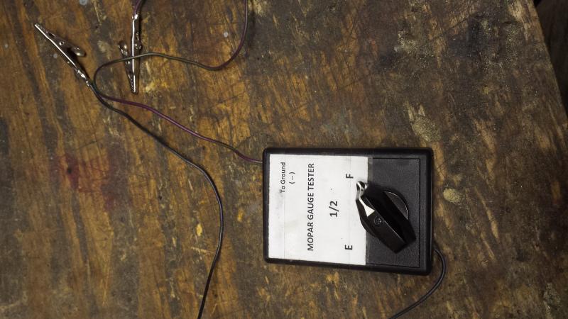

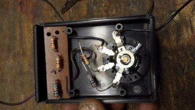

Built a gauge tester. Nothing groundbreaking but it gets used quite a bit. Housing and parts bought from Mouser.

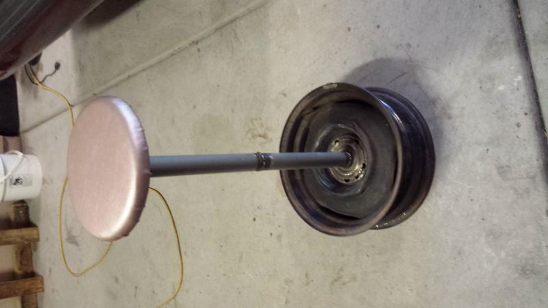

And I just built this stool from a 15x6.5 mopar rim and some scrap steel bases. Vinyl is nos rose beige.
Id like to see more details on this stand. about to start putting my 72 GTX back together

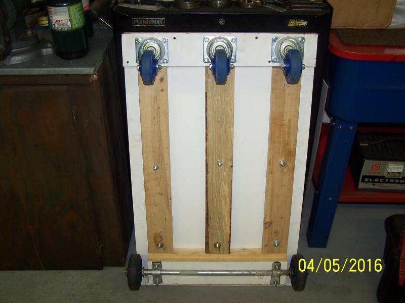

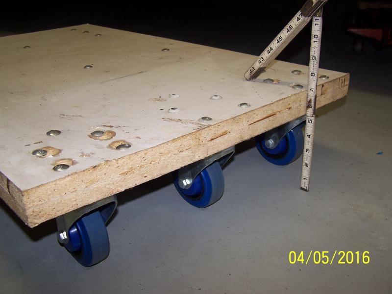

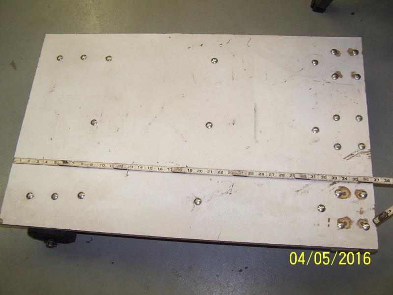

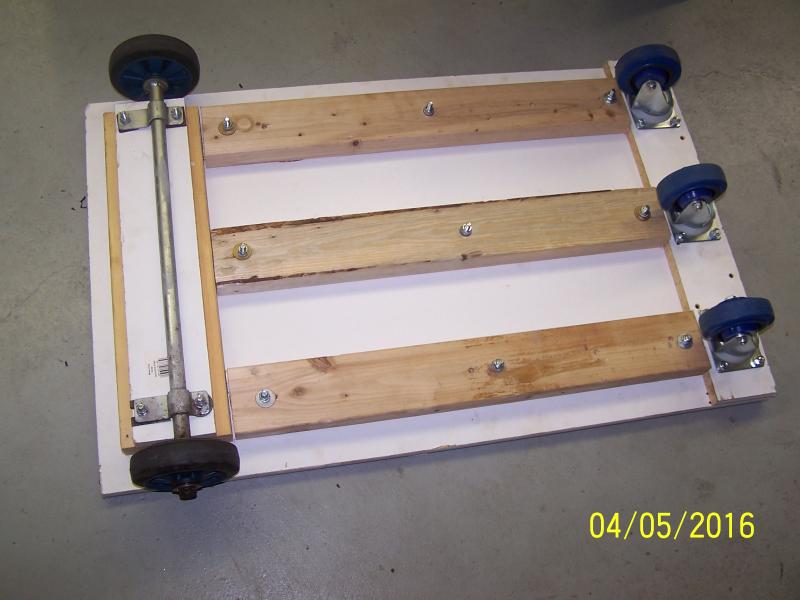

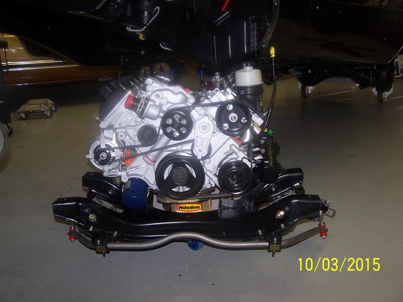

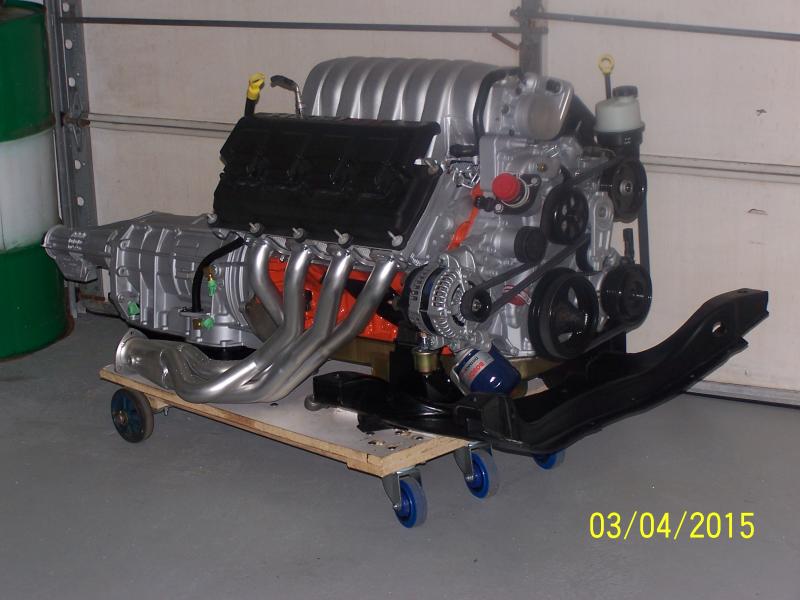

Here are some pics of a drive train cart I built out of wood. I don't have a welder so this worked out just fine for me. i have used it for three installations. Probably had it in and out of my Charger a dozen times during mock up and final install100_7667.jpg100_7668.jpg100_7669.jpg100_7671.jpg100_6860.jpg100_7304.jpg
