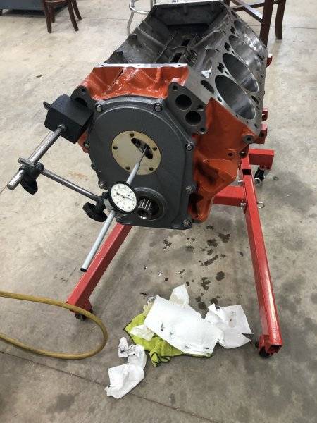

The 440 I built last year had a roller cam & t/c set up with a thrust button was used. I carefully machined the button for 0.005" endplay, using the factory t/c cover. With the water pump in place, there is a small gap between the back of it & the t/c cover. I glued a spacer in there that was a neat fit so that the t/c cover did not move.

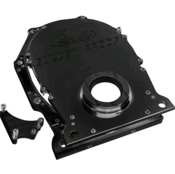

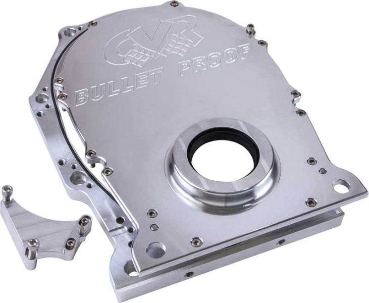

My builder sent me a picture and description of the one he uses and has had no problems with, which is about $80 less than Andy's. I asked if there's any advantage for my application in using Andy's vs the one he uses, but I'm not going to change cam timing keyway adjustment so I am just going to use this one:
CVR High Performance Racing Products. Bright anodized T6-6061 billet aluminum. Eliminate flexing problems holding cam in place and keeping timing control. Covers allow camshaft to be replaced without disturbing the oil pan seal
Note: TC2440** includes timing pointer
I have to decide which of the 2 to use. The block is going to remain natural aluminum, but my CVF Wraptor system is "Black Diamond" which is black with aluminum highlights.
Feedback welcome, especially if anyone has used this one or may see an advantage to Andy's that we missed.
