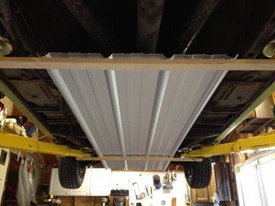

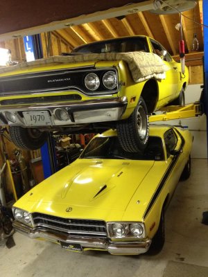

So I finished version 1.0 of my drip protector.
I took a piece of galvanized roofing and cut it down to 36 inches wide. Then I simply took two strips of wood and attached them to the bottom of my lift using some wire. The roofing just slips on top of them.
The wire will come off easily enough, but maybe I will experiment at some point with hand clamps to make setting it up and removing it easier.
This works for now. I offer the following pictures so you can either bust my chops or get ideas from it. As you wish... :eusa_whistle:

LOL. I think the drips from the 70 will "paint" the drip protector!
Hopefully, soon enough the 70 Road Runner will return to its original Lime Light. That will break up all the yellow (but still be quite bright). For now, there is massive confusion in the family, since "the yellow Road Runner" can be either of the two cars!

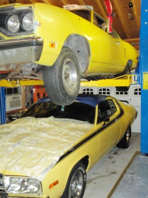

If you want to use mags., then use Earth Magnets, very strong. I just used a blue tarp & attach it with those plastic hand clamps, works for me.

Looks good!
The only other thing I'd think about is how much the upper car drips? Could it make a puddle that woud run to one end or the other and drip off? If so maybe a thick bead of silicone caulking or even low expansion spray foam across each end of the metal to make more of a trough.

I use washing machine drip pans. The are pretty big, and two will cover everything from the radiator to the tail shaft. I've been using them for years. Easily available at Home Dopo. You can either put a towel on the bottom car and just lay the pans on the car, or use the magnet idea, that sounds great too. I have two four post lifts and plan on spanning the ramps with the pans or 2x4s.

I agree that's a good idea. Luckily, I don't have any major leaks, just a drop here and there, so I am OK for now. However, one day, I'll likely need that protection. I should add a quick bead of caulk when I have some extra from an open tube...

I'd make an upside down tarp tonneau cover for the lift. You can buy the little buttons and just add them to a tarp here and there then screw a few to the lift. Then the tarp is just snapped on when you want it and snapped off and folded up for later when not. you could even come out farther if you wanted and cover the wheel drips if you have a place to attach it.

I'd be worried about knocking that piece of roofing off of there by bumping it and having it come tear the paint of of whichever yellow roadrunner happens to be on the bottom at that time.:jerk:
Walmart has large trays in their auto section. They are about 24" by about 48" and look like a large cookie sheet. These have a rolled safety bead all the way around them. A friend of mine found that on his 4 post they slide right in. I think the cost is $10 each in Port Huron MI.
