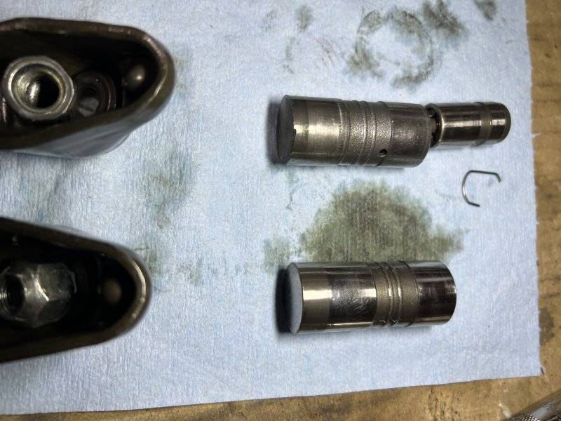

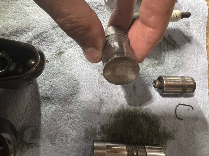

I think I found the problem. Intake lifter broken retaining clip and trashed it. Hopefully the cam is ok.
Wow that lifter sure is a goner. Dang those cheesy snap rings...I can't see how the cam lobe would still be okay but you never know.
What lifter, factory/aftermarket?
Snap ring broke after the lobe and lifter ground down ro smithereens.
The oil burning is likely the cylinders scarred bad from the lifter grindings.
Drain the oil and have a look.
Put a magnet in the drain hole and see what kind of goodies come out
Looking down the hole and feeling it, the cam might be ok. Draining the oil tomorrow to see what I find. I did find the other small part of the clip but I’m sure a bunch of metal went through the system.
Not sure what brand of lifter but they might be Melling.
Decided to measure the lift on the cam lobe and it’s junk. Only.140 of lobe lift left (by comparison #1 intake has.276).
Going to recommend moving on to a roller cam setup.
