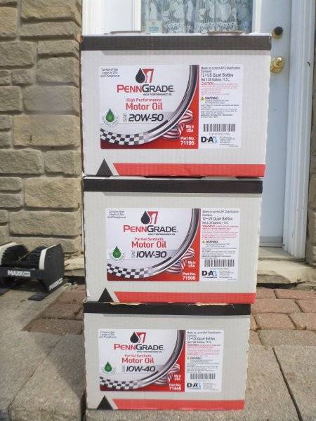

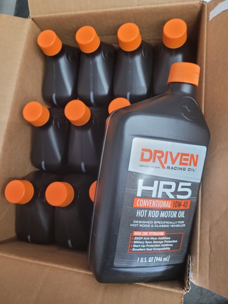

I much prefer an oil designed for protecting a flat tappet cam than adding an additive to an oil The off the shelf brands of oil for modern gasoline have less zddp, and heavy on detergents that scrub the oil off parts, (like your flat tappet cam), but extend the oils life. That isn’t Driven, Penngrade, Valvoline VR1, Amsoil Vrod, Lucus…just to name a few, that are properly engineered for flat tappet engines, and need no additive for zddp.
This is almost exactly what Dwayne Porter told me.
I had a cam failure in 2022 after using a new synthetic ( high detergent) that claimed to have extra ZDDP. He thought the detergent served to wipe away the ZDDP as fast as it touched the metal, rendering it useless.
Also, he argued against pour in additives based on the belief that they may not be compatible with the oil, that they could be worthless or even negate any benefits by conflicting with the existing chemistry of each other.
