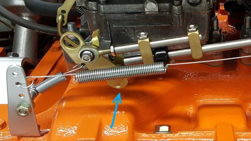

I believe the lever arms are different from the original carters. (We have had this discussion here before, for someone who couldn't get edelbrocks to work on a crossram (@Frustration ?) I would suggest trying to get a throttle linkage setup, then look for carbs. You might ask @khryslerkid about the linkage he uses on his inline dual quad.

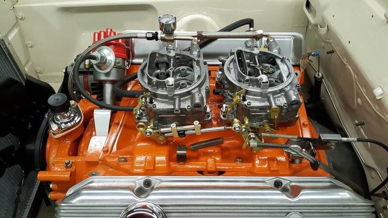

I chose the more economical route with a pair of 1405 Edelbrocks and a factory 413 inline manifold. The problem is the secondarys are smaller on the factory four barrels and the manifold has to be opened up in order to use the newer Edelbrock with larger secondary throttle plates. Or find a adapter.

Bought the Edelbrock progressive linkage and the adapter. Removed the front choke plate and used the manual choke on the rear. The progressive set up had the front cylinders running too lean so I locked it out to a one to one. Runs great.

@moparsquid if you're sticking with period correct, I think you already figured out you'll be needing View attachment 970072
https://www.forbbodiesonly.com/mopa...up-new-residence.114133/page-4#post-910568147

Forgot to add, using this manifold, don't know if you'll find the same on the 383 manifold, I had to round of the bottom of the throttle on the front carb so it would pass the runner. Also using a 1/2" Edelbrock wood spacer to help with clearance and heat sinc. No problems with the rear carb.
