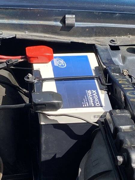

Well I decided to take the plunge on the XV2400 Lithium battery.
My son needed a new battery for his '65 Valiant and I really wanted to try this battery in my Doba -so the timing was right.
Of course it dropped right in--only change I made was installing a variable voltage VR (another recommendation from RE in Mopar Action)

We'll see how it holds up! :thumbsup:

Once I got the battery and included instructions they recommend not charging over 14.5 volts -- I had checked 2 factory VRs on my Cordoba and they would charge up to 15 volts on cold start!
I would recommend getting the variable voltage regulator because of this -- these batteries are very voltage sensitive.
Been running mine for about 10 days now-- no problems-- adjusted mine for 13.9 volts-- has not gone over 14 volts and with all lights on (interior and exterior) reads about 13.5 volts

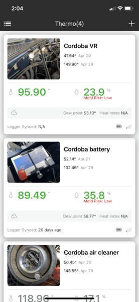

I have checked my under hood temps and so far have only seen about 120 F at the battery--granted it's not the middle of summer but we have had mid 80s
Got a few of these Bluetooth temp/humidity sensors and placed them in various spots under the hood-- so easy being wireless now.
Here's a screenshot -
That’s awesome! Thanks. Would love to see battery temp after extended idle and after engine shut off heat soak for fuel up.
