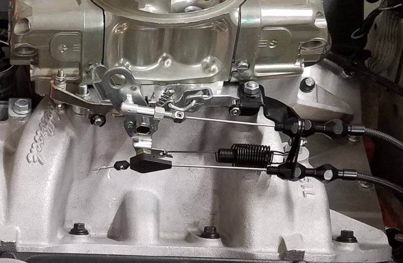

Not sure what you mean by 'gearshift control lever'? The only springs on the Lokar setup connect from the throttle lever of the carb to the Lokar mounting bracket. Two springs for safety. The kickdown cable itself, at least on mine, is what adds a tad extra stifness to go-pedal movement but it's not much. With the kickdown disconnected the pedal is way too easy to push (not driving it around without the kickdown anyway).

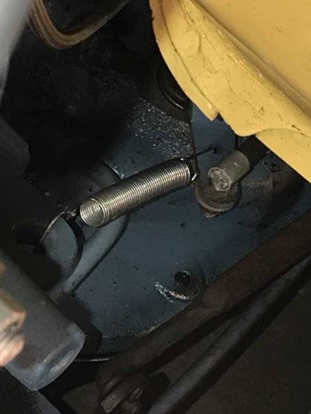

I have the same exact setup as post #2. Mine also has a spring at the lever, see pic. There was one there when I got the car, but it was rusted so I went to hardware store and got an assortment of springs. The one on there now seems to work perfect. I feel no pedal issues and the trans downshifts fine. I would say it was a "lightweight" spring... just enough to hold the lever back.
