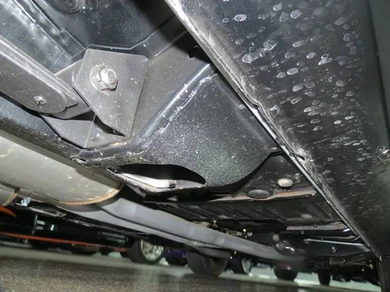

I dont see the leaf spring reinforcement
What should be there
( disregard the spring hanger on mine, Its aftermkt so I could lower the car )

What does the improper spring reinforcement tell you?
Could be any number of things.

Could be nothing . Maybe its there only hidden by the leaf spring bracket , maybe it was never there from factory , Mistakes did happen . So its not a 100% deals off deal breaker
BUT ,,,,,
I dont like to say it. It just raises some flags to inspect closely for signs of rebody
The rear spring reinforcements are there, ck for the added pinion snubber reinforcement and associated welds
BUT ,,,,,
