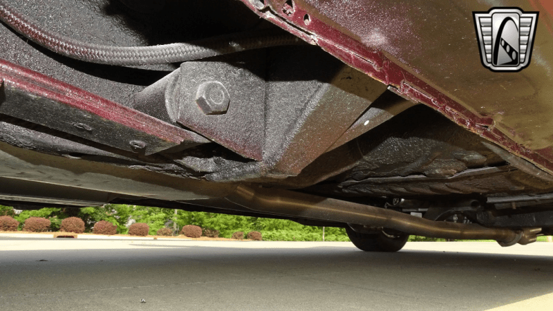

So far in watching the video something is amiss with the accessories / belt drive system squeaking.. the controls look a little funky also for the AC.. looks like Vintage Air.. not sure how the controls for those work. Also, a little suspicious of the undercoating on the rear trunk pan and frame rails.. those doesn't look to bad from pix. would have to check it out in person for sure.. in atl. Notice a small pin hold in the seam crimp on one of the wheel well pictures (passenger front back side of crimp opening).. im wondering if that's a indicator of a bondo/filler slap repair job. sure seems overpriced based on condition and lack of originality..A12s aren't hitting $60k at BAT

That hole is for wheel-opening moldings, NA on '68-'70 Road Runners, so the fender's been changed. It's a custom car, so lots of those details are incorrect vs an OEM restoration: hood blackout should be organisol & come to a point in front, dash should be organisol, seat medallions are missing. Looks like nice paint, but they oversprayed the underside of the car rather than properly mask it off. $83K is a LOT, IMO, when a correctly restored #s car is probably a $50-60,000 car. I guess the guy's adding value for the restomod stuff, but still...

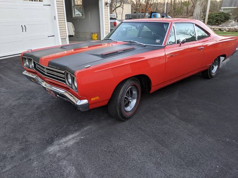

Nice outside paint. Personal preference but I think in 10-20 years a guy would be happy he pursued that A12 instead. But that's just my opinion. For asking $83k I don't expect "cover up" undercoating. I would want properly coated surfaces all under. I know it costs lots to build a car these days and that outer paint would probably cost $20k up here if you paid a pro, I like this one better at $45k though.

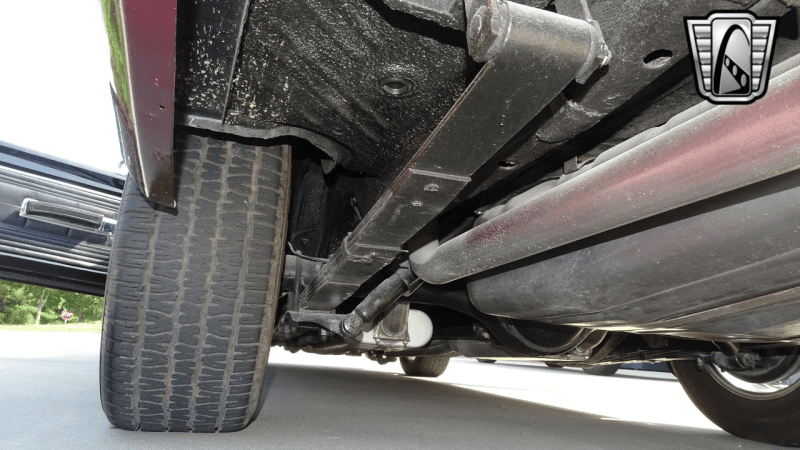

1. Over sprayed under carriage and exhaust and fuel tank. For the asking price I would expect a top notch paint job and that's a complete lack of attention to detail that I would do in my garage for a budget driver build.
2. That overspray on the exhaust isn't burned off even. It probably hasn't seen an hour of running yet which means the gremlins haven't been chased out yet in all likelihood.

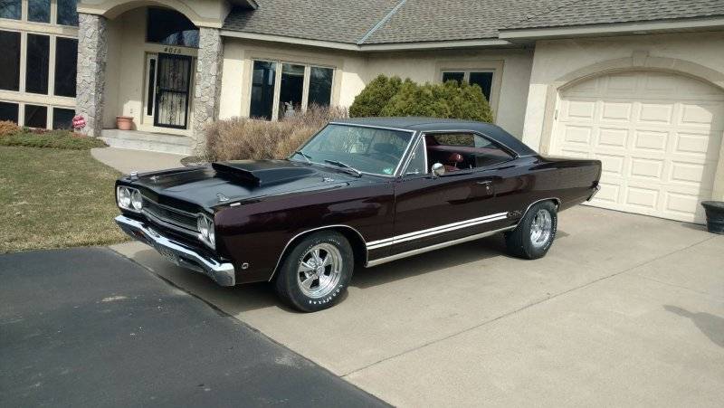

Heres a shot of my beloved X. One of the most difficult things I didn’t have to do but decided to. Find a car like this and you’ll be a happy man and your quest will be over.

When I see things like body paint on suspension parts, painted over hood spring , etc etc.
