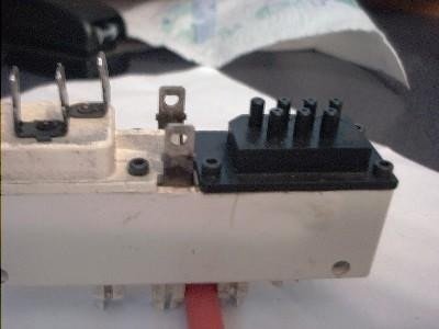

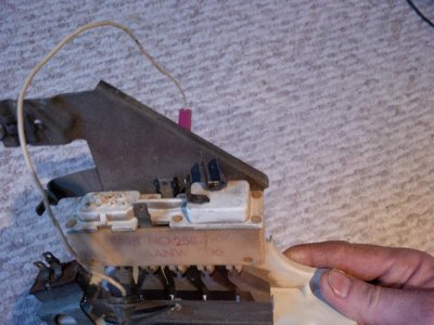

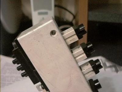

IMG_20150531_104630.jpghi I have 2587564 vacuum switch that was brutally removed by the previous owner that im trying to find a replacement for. I have found several others on ebay that look similar but the terminals are slightly different and im wondering if I can just re pin the electrical plug or are the vacuum ports all botched as well?

If you trace out what function the terminals have it's pretty easy to retrofit the five button controls with later b body unit from Napa or another vendor. The only real difference in operation over the years is whether or not he A/C compressor comes on with the defrost function or not. I actually like this added functionality in our convertible. Make sure you don't order one for a c-body. They do not function the same and will not work.
