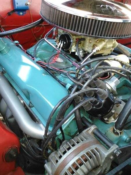

The set I’m using right now came from Summit and long tube for 400 block (will fit 383) went in pretty good had to undo steering linkage to get drivers side in and use mini starter. Other than that went ok.
