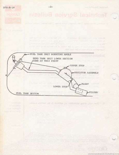

Even the factory senders had some trouble....TSB from way back:

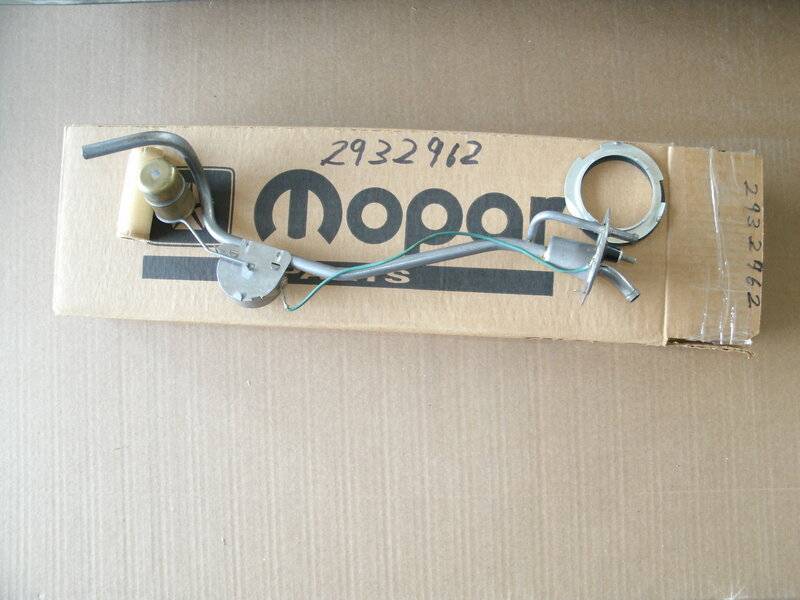

Well then maybe i better hold on to this NOS one....2947693
Woah, is that one 3/8"??
That thing is unobtanium!!
