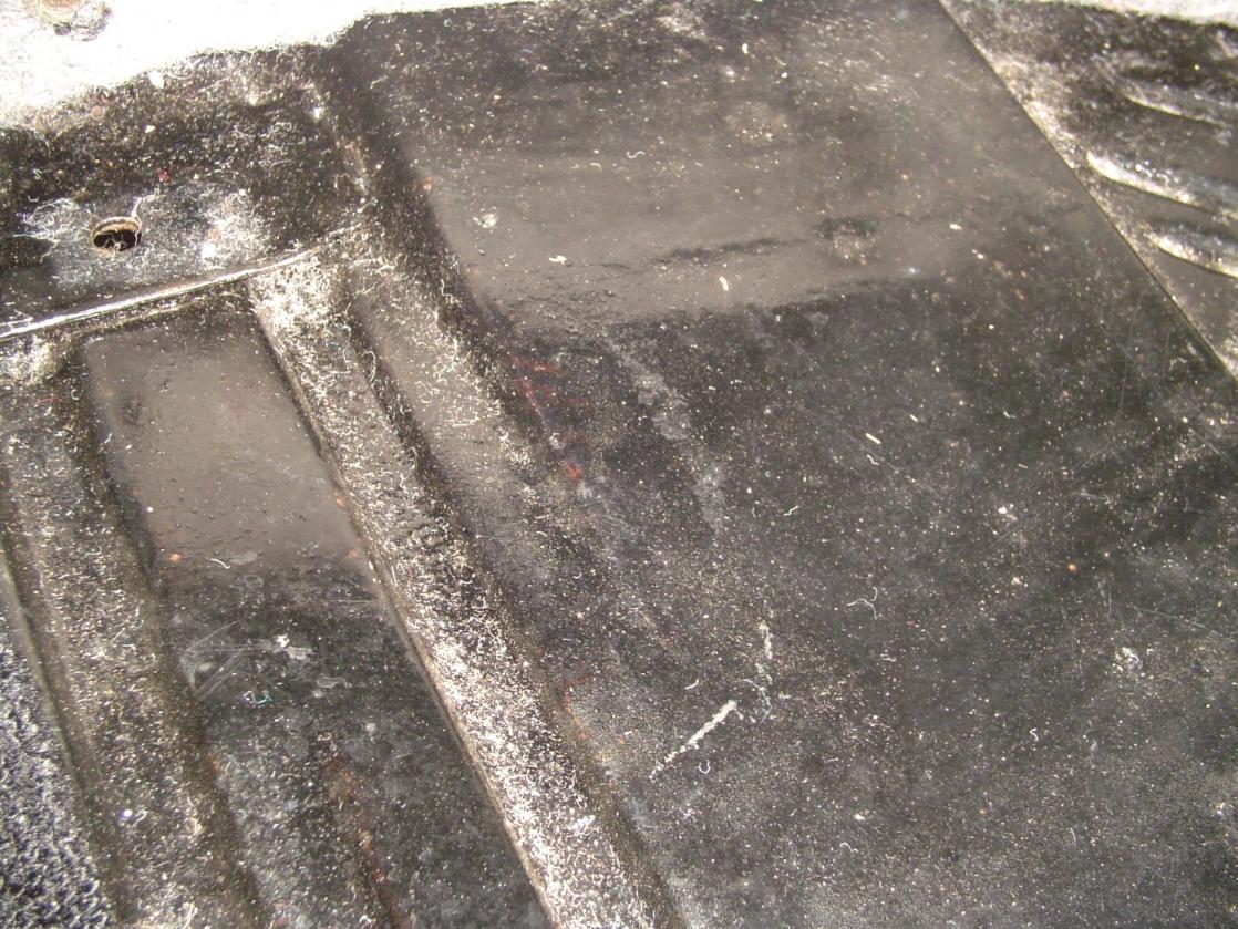

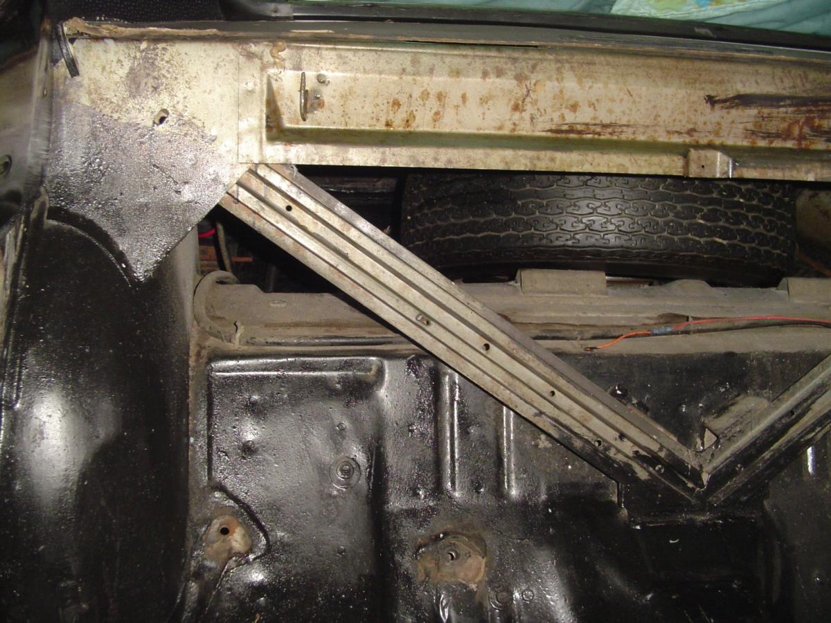

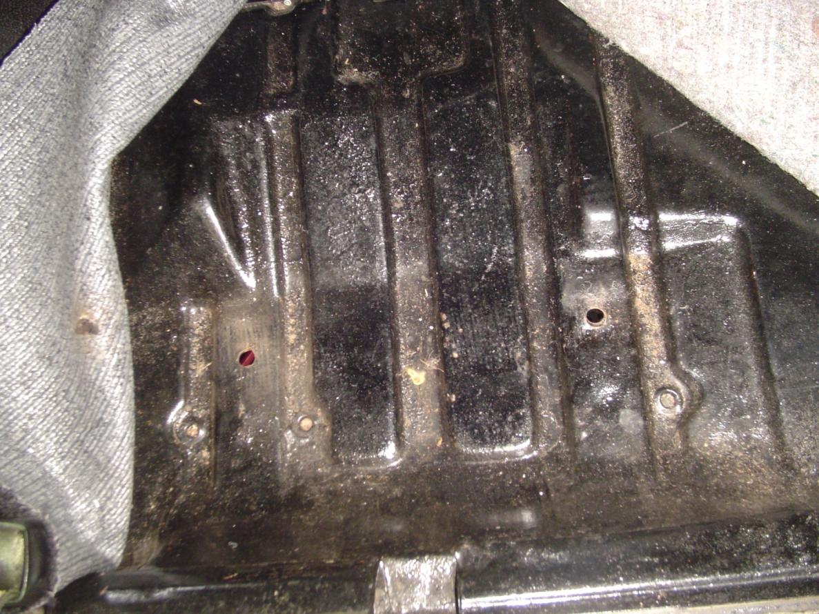

I wouldn't pay $10,000 for it. If the engine compartment was original looking, the top of the grill wasn't fiberglass, the motor was original, that tach and shifter were removed, the interior of the doors was black, and there was a fender tag, $20,000 would be pushing it.
I inspect vehicles for a living. From the photos I have spotted so many indications that tell there are a multitude of sins lurking under every inch of that car. I just imagine what I could find in person.
Hold on to your wallet with the $25,000... and run. I am serious.
Lots of scary looking stuff here, my guess is a couple very soft rear frame rails/floor sections and some very poor restructuring. The seam sealer in the rust hole on the one shot of the frame rail is a classic butcher job. Seeing the poor quality of work that is obviously freshly done would only make me question the rest of the body. 25K is alot of cake for a car that needs to be gone through and I see a ton of things that need correcting, too long a list to mention. If you are considering this car, pay a good body tech to have a look, it'll be the best $ you spend on the car!

It looks like there is Fiberglass resin hidden underneath that black paint stuff, don't know for sure, but in my younger, dumber, days I admit I used that stuff to fix many floors/fenders...hell everything!
