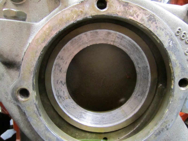

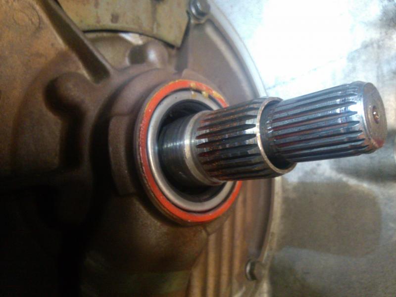

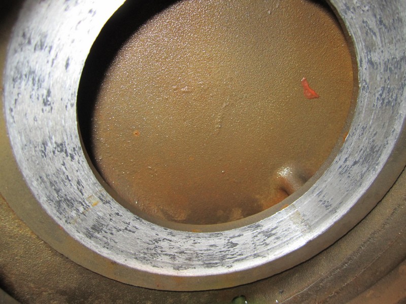

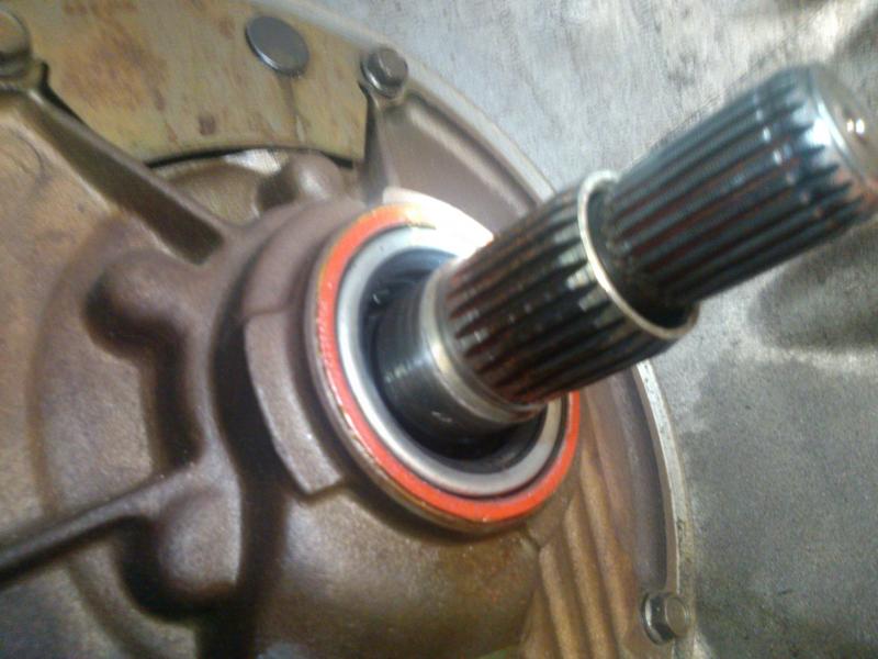

Heres some pictures. Nothing immediatly evident. Splines looks ok. Im running out of ideas guys. Any thing i can check out internally? If i pull the front pump, can i get it back together easily?

Your trans pics "look" normal to me. I don't believe its the starter. HEMIITIS water pump pics could make that noise, but you loose me on that when you say you ran this motor for 300 hun miles. (something in the cooling system got jammed in the pump impeller maybe?) Hmmm, how are things looking on the flex plate area? The noise doesn't sound like its "in deep" so to speak. Converter only spins one way (internally) right?

If you pull the trans pump out you will need a new seal and gasket and some vasaline to put it back together. Why can you guys with these crazy problems never be closer. I have a 4 speed bellhousing and flywheel just sitting here that we could throw on quick to eliminate the engine or trans as the source
