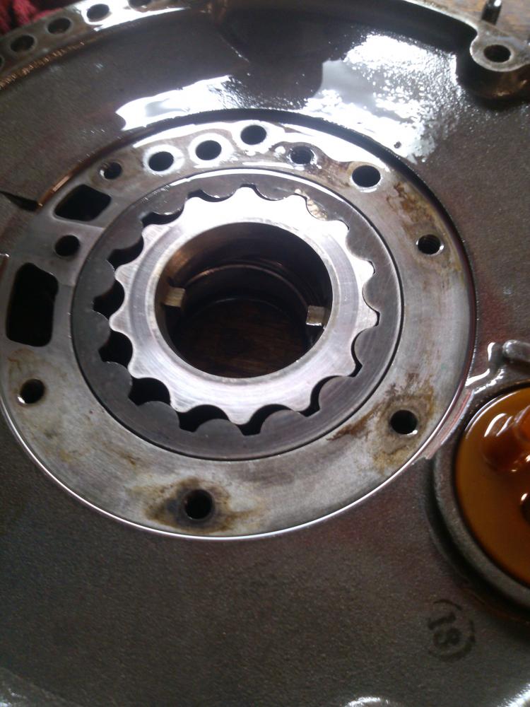

Did you check end play between torque converter face and flex plate when converter is pushed all the way into trans? it should be a minimum of .250 inch. Another way to check is push converter into trans carefully till it locks. Then measure with a straight edge from the mounting lugs how far recessed into trans converter sits. if it is less then this amount then check for bent flex plate. You may have used a big block flex plate on small block. If this turns out ok. then pull oil pan and check thrust bearing face surface for destruction. this can be seen without pulling crank. if the Converter face does not have this free play, it destroys the thurst bearing face. i f you can not get a good look then your going to have to drop the thrust bearing cap. Do you remember if the re builder set the thrust bearing? it is done with a Brass block held on the snout of crank, with one rap of a sledge hammer to seat the thrust surface. A light rap
