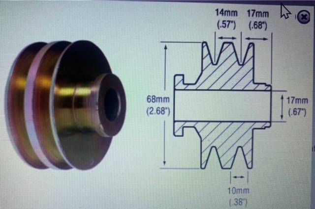

Mini Lathe shouldn't have any trouble doing what needs to be done...Following this because while I don’t even have a working heater blower, eventually I’ll have AC and will want a good dual belt pulley set up. If it’s a lightly modified Toyota unit I can get at FLAPs all the better. Could this machining be done on a HF mini lathe? I only need flimsy excuses to buy tools.

Well your the exception.... I've dealt with it a bunch... The low mount big block Sanden is practically un-usable on a hot day.... The small block Bouchlion kit that runs a single belt warns of slippage concerns on the website....I have run both single and dual belts on the Sanden type A/C compressor and found no difference, no slippage with a single. Besides it's hard to find a matched set of belts anymore. I can understand it on the old York compressor.

I have the Big block kit from Bouchillon in my Valiant.Well your the exception.... I've dealt with it a bunch... The low mount big block Sanden is practically un-usable on a hot day.... The small block Bouchlion kit that runs a single belt warns of slippage concerns on the website....
Not until you add a bunch of items that require more power to be sent through the stock wiring, that is. Because the OP obviously has a rather robust draw if his meter goes down to 10a at idle. So, my question remains, is anybody worried about the stock sized wiring when running an alternator over say, 100a?
Straight from the Bouchlion website... About their low mount Big Block kit...I have the Big block kit from Bouchillon in my Valiant.
Low mount compressor kits are all about vanity.. "I want A/C, but I don't want anyone to see my A/C".... Hey, hidden is cool, but if your limited to local drives what's the point....What the crap is the point of installing a kit that you can't drive or has belt slip issues? Seems like a waste of money.
