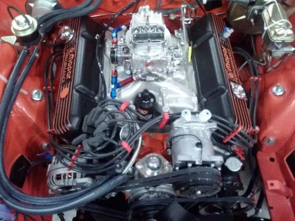

Pump gas engine running unleaded premium. Intake was ported by Wilson Manifolds, solid roller cam. Should run 9's if you can get it hooked up: http://www.hotrod.com/articles/dyno-tested-vacuum-pump-help-engine-make-power/

THANK YOU ANDYPump gas engine running unleaded premium. Intake was ported by Wilson Manifolds, solid roller cam. Should run 9's if you can get it hooked up: http://www.hotrod.com/articles/dyno-tested-vacuum-pump-help-engine-make-power/
