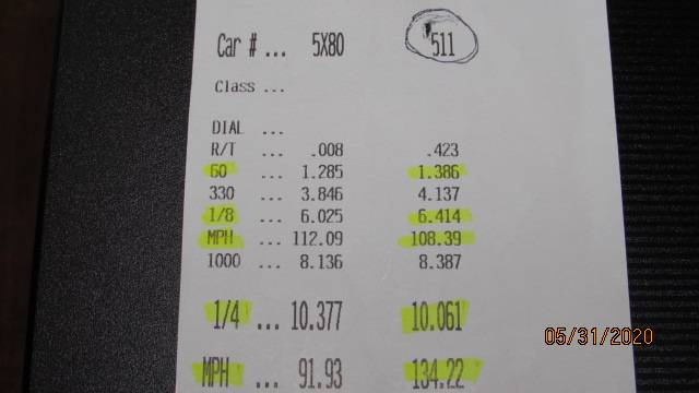

Tested my buddy Daves 67 Satellite at Milan last night. This car just got updated with some touch-up paint work, new cage, Dana, DVW race trans, 512" just over 11-1, TF 270s and intake, 4150 Holley, Hooker race headers, 270ish roller thats probably not ideal, 8" converter (no flash test), 4.10 dana, 9x30 M/T radial slicks. The car has glass hood, deck lid, bumpers, light seats, moly cage. He's around 250lbs. I would guess it weighs around 3300. ran a 1.42/[email protected] ouut of the box. Backed it up with a 1.40/[email protected]. Heard a noise on the 3rd pass and lifted. Some how the right rocker shaft center bolts were loose. Pushrods off the rockers. We pulled the shaft and inspected everything. No damage. So I put it back together and torqued the shaft hold downs. When checking the lash all the center readings were tight. So I suspect the bolts never were fully tightened during assy. This is why I torque everything when I build my stuff. I checked the left side hold downs and lashed it as well. Went back and ran a [email protected]. So no damage done. He didn't have the instructions for the play back tach. So no converter data. It hooked great. Personnaly I think it should go quicker. No jetting, timing, or lash changes yet. 36 degrees total. The carb has been dynoed in the past with good results. Car ran clean

It went 9.94 134 yesterday in testing. 1.070 correction factor.

Correction factor is the weather in this case 7.0% worse than dyno correction. Similar air last night 1.068. But with 105# of ballast added. 9.86@134 at US131.

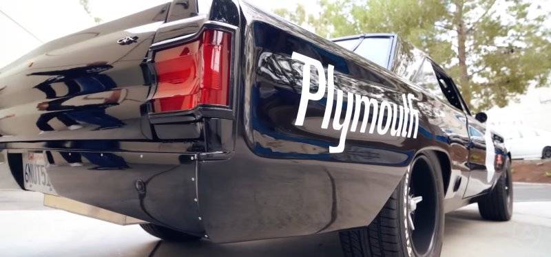

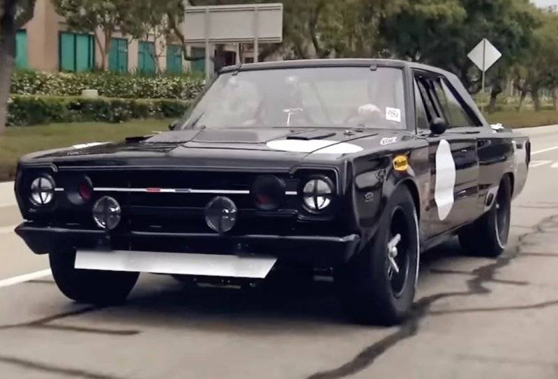

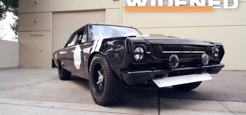

I made a short clip of the full video where he describes the front and rear fender widening. The Coronet has "hips" built into the rear quarters vs the Satellite or Belvedere, but the bowed fenders on the Plymouth look great, IMO.
View attachment 1479809View attachment 1479811View attachment 1479812
✂️ front and rear fenders widened
The rear quarters on my 68 road runner were 'pulled' out a bit too. Hard to see if you weren't looking for it.
