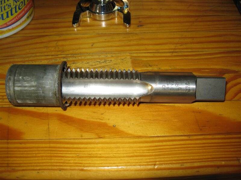

Found this piece of information on Youtube and thought I would pass it along. I used a 1 3/8" tap to get the inner sleeve out of my lower control arms. Actually worked. I don't own a welder (yet) so this was a cheaper alternative. The tap was about $80. Threaded it about 3/4 of the way down and then pressed that inner sleeve right out..no damage to the control arm at all. Pretty neat!
Joel
Been doing it that way for a while now. Works pretty slick.
