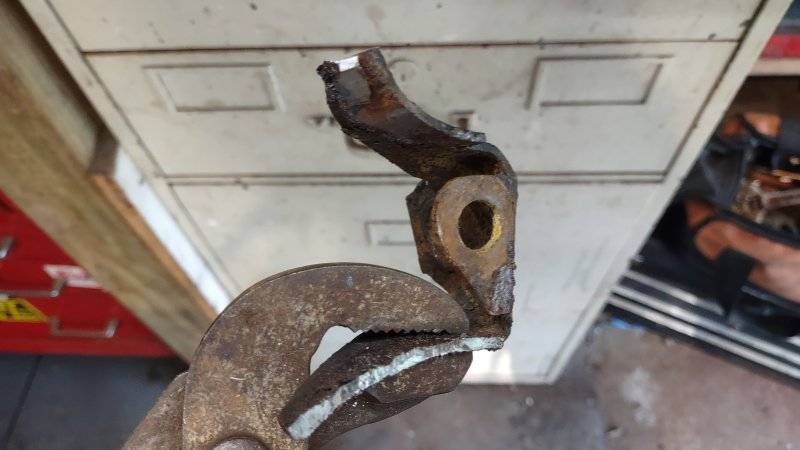

I pulled the front end apart on my 66 Charger.
The last time was around 1989/90 timeframe.
The passenger side lower was seized up.
After soaking it and beating the adjuster back and forth it freed up.
Maybe too much.
If I clamp it in the vice at the torsion bar socket with the arm extended out horizontally I can move the end probably 1/2" up and down pretty easily.
I'm thinking I'll cut the sway bar bracket arm off and weld it on the arm from my Plymouth and use that instead.
I have the reinforcing plates to weld on the bottom as well.
Any ideas and suggestions?

There's a lot of movement between the two stamped arms where they rotate on the torsion and pin axis.
I know the strut rod would help but that has bushings as well so it seems like the Lower arm would move forward and back while driving.
So not good for handling.
I think the arm isn't worth using.
But maybe if I squeeze tem together and then weld on the stiffener it would tighten it up?
well.. put that end of the arm in the vice to slightly tighten the end the socket is in then try to move the t-bar socket.. if it's tight you found the issue and put on the reinforcment plates and good to go :)
It was loose so I cut the bracket off.
I just didn't want to trash my original arm of it wasn't necessary.
