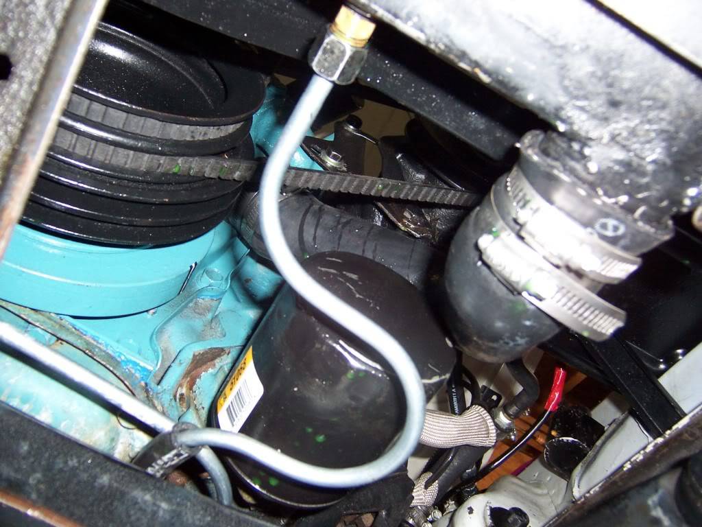

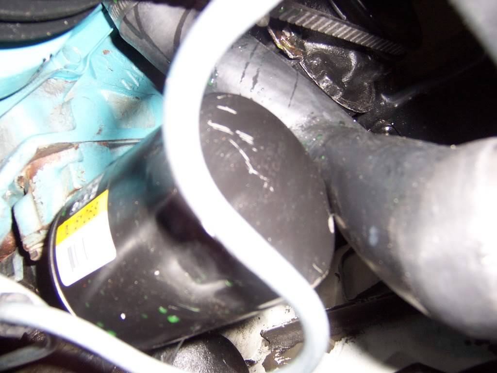

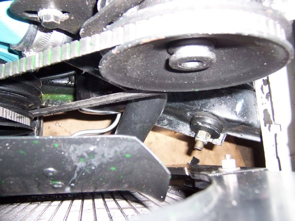

Since I'm not the only one to have a 62-5 "B" with a big block and a 318 radiator,I'm hoping one of you cats can help here. My issue: lower hose clearance around the oil filter. I'm running a 16" flex hose now,and it's putting enough pressure on the filter to slightly unseat the gasket(and it's on tight-the filter,that is) and cause some oil seepage. Tried a 19",and the damn thing kept kinking when I tried to install it. Has anyone found a molded hose(or a couple that can be modified) that makes a SHARP right angle at the radiator fitting,to clear the filter,and then around to the pump housing.? I'm not ready to drop 7 Benjamins on a new Mark 7 radiator(though I want to) for proper hose placement for a B/RB mill,so I want to work with what I've got and put that money into something else. Plus,I had the radiator re-cored last year($$$) and want to get my money's worth!
Any ideas,folks? If I absolutely have to,I'll get the new rad,which also means a new shroud,since I had to modify my current one to fit the 318 radiator. I'm looking at a Grand for all that,and that was planned as my machine work fund.
Oh;I'll get some pics out here later to show my dilemma;might better explain things. As always-THANKS!!!

Oh;the shroud I have is the Mancini Racing unit,meant for a normal 62-65 big-block radiator. I had to do some trim work to make the top half fit on my 318 radiator.

I had the same issue, seems like i used a Gates lower hose for 68-69 Barracuda w/383. it had to be trimmed a little. trying to find my receipt. i also run the smaller oil filter. hope this helps John
THAT'S what I'm talking about! Like I said before,there was a molded hose on the car when I got it;it was so freakin' old and stretched that I wrapped it in electrical tape just to get by. John;I'll check one out at the parts store tomorrow and we'll see what transpires. Hopefully this will help someone else out as well. THANK YOU!

MAJOR thanks to Johnhinds;that hose fit very well on the car. I'll be able to remove and install the oil filter without using compound cuss-words. For those who may also benefit,it's a Gates #20609 lower hose for a '69 'Cuda with a B/RB motor. Bug your parts store guy or gal and don't let 'em tell you that there's only a flex hose available! There is a molded unit!
One note: because this hose has 1-3/4" diameter openings in both ends,and 318 radiators have a 1-1/2" fitting,I found an appropriate hose,cut a 1" or so piece and slid it over the fitting. Put the lower hose over that,double clamped it and NO LEAKS!!! I also had to remove about 1-1/2" from the end that I used on the radiator fitting. Yeah,baby;now to deal with the trans leak issue(yet to be found) and we be rockin' the streets soon.
Glad i could help,I may need your advice someday. Gates makes a rubber bushing for your lower rad. hose,it goes on your rad. then you put the hose over the bushing, that makes up the differance from 1-3/4" down to 1-1/2". lets just say i have a very knowledgable parts guy when it comes to Mopars. John
