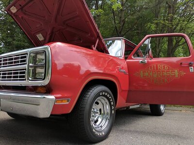

LR and GR is what the 78 Lil Red Express used. Those trucks get 245/60’s in the front and 275/60’s out back.
Drawing on this post. I would like to find a replacement pair of LR60/15 for my LRE. I have 3 matched Goodyear Eagle ST White Block, and 1 Goodyear GT Radial white outline letter. I am not interested in replacing my beautiful stock rims, so I would like a pair of 275/60 15 Goodyear Eagle ST White Block, so I have a spare. Does such a tire exist? And where does one recommend sourcing it from?
Western
Chrome five-slot disc road wheels (5) 15"x8"
GOODYEAR
Raised white outline letter radial tires (5) LR60x15
This did me no good... https://www.tirerack.com/tires/tiretech/45_conversionchart.jsp
and the link here was still jibberish, so as clearly as possible please advise.
I haven’t seen any repops like the stock LRE tires. Closest thing is someone repops Goodyear’s for a late 70’s C3 Corvette.
And yes, never give up those wheels.
If your in Facebook join a group called NARLETO. The people with original parts are in that group.
I don't think they have made the Goodyear eagle st's for at least ten years. If you found some, a good chance they would be too old to use.
You might try Cooper cobras, or Mickey Thompson sportsman S/T.
