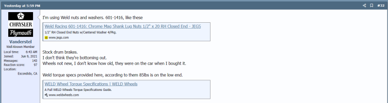

I'm using Weld nuts and washers. 601-1416, like these
Stock drum brakes.
I don't think they're bottoming out.
Wheels not new, I don't know how old, they were on the car when I bought it.
Weld torque specs provided here, according to them 85lbs is on the low end.
If they were bottoming on the hub, I doubt they'd loosen. If bottoming on a swedge, perhaps. IMO, maybe get a wheel of and check.
How much actual thread engagement do you have?
Are the lugs sloppy on the studs without the wheel?
Washer condition?
Problem is if they are bottoming out the wheel will not be tight. Poster has not responded so who knows whats going on.
This is the OP response, right?
Nuts are not sloppy on the studs.
All nuts and washers are new.
I think I'l give Weld a call.
