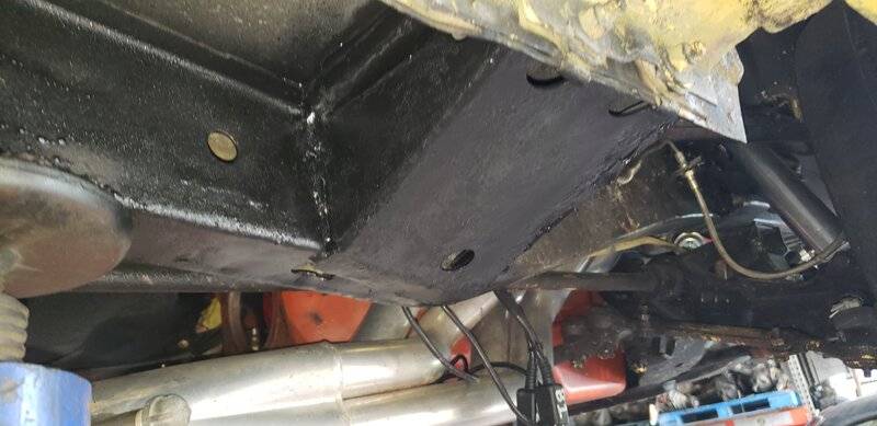

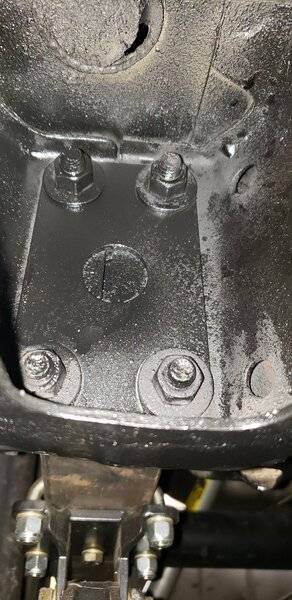

Along with the front and rear torque boxes, and subframe connectors, I also had inner and outer front spring hanger reinforcement plates put in.

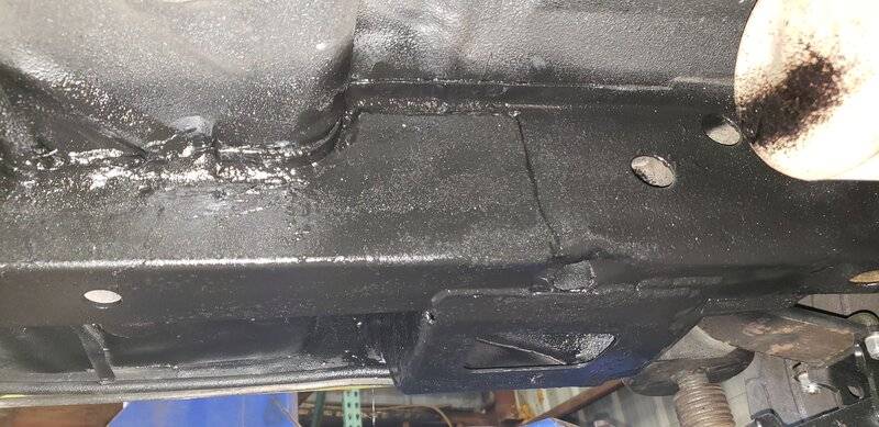

Anyway, THIS "round" of massive add ons, mods, systems installed, etc for my Roadrunner has TREMENDOUSLY improved the stiffness and stability of my frame and suspension, as I went from factory stock to: USCT subframe connectors, front and rear torque boxes, and inner and outer front spring hanger reinforcement plates.

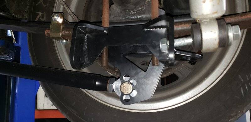

his stuff is chrome molly tubing , he's not annealing the tubing after welding it . tig is hot and needs annealing after welding parts together , mig is less hot , but still requires it tobe done to welds for chrome molly to flex without braking at or around the welded area . he should know all about this process , he claims to be a pro welder .
At first glance the cracked/failed arm almost looked like alum.
I am a certified welder. I believe the annealing you are referring to would benefit the HAZ (heat effected zone), and that is where the cracking would be mostly located.
What I see posted here is a fractured weld and that makes me question what filler rod was used with the CM assembly.
The annealing/HT is not per se "required" and is often in the real world skipped for cost/time savings, but it is better if done, and I send my stuff out to a HT vendor for peace of mind.
