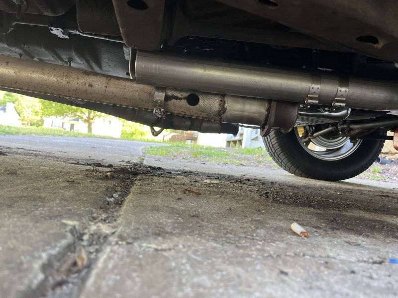

Wondering if anyone else has run into this situation. Headers fit the big block in my car (66 Coronet) however, the collectors did not line up with the reliefs in the trans mount cross member. So, I picked up some 3" exhaust pipe and fabricated collector extensions that end just past (to the rear of the) trans mount.
Questions: did I modify a set of headers that were designed for another B-Body? Does someone make a good set that will fit a 66 coronet without modifications? Or is this just how it is?

I just somewhat fixed the roadrunner hack job exhaust. I do have to fix the trans line issue but much better.
Before.
After

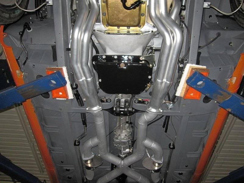

My 65 with TTIs:
This was after I bent what I felt was safe to align the drivers side horizontally. Insert large steel pipe in collector (header snug on engine) and apply pressure! The rest of the relocation was welded into the street hook ups.
Mike
The cheaper headers just aim straight back from the engine. TTI and Doug’s cost a lot more but they are aimed toward the humps in the crossmember.
