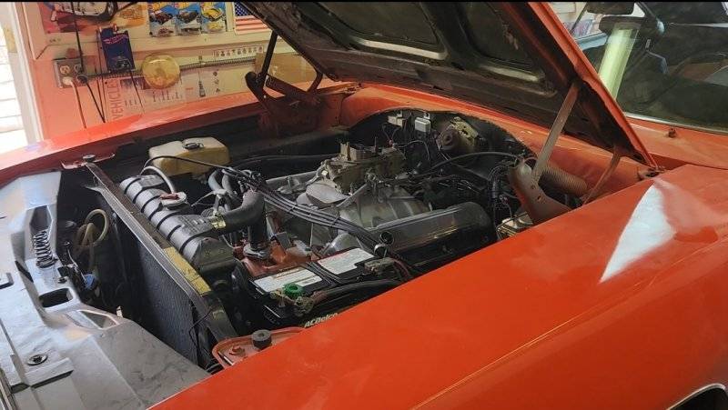

My current rat's nest:

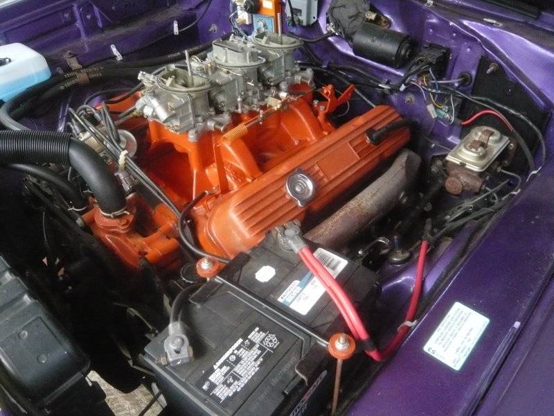

Get a 6 pack set up and you will be happy. :steering:
