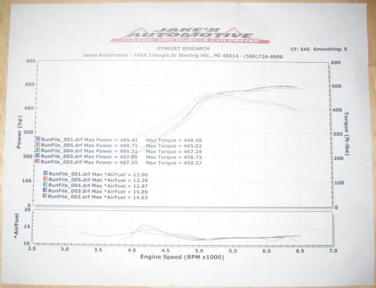

I came close enough (for me) to 500RWHP with a street B engine about 20 years ago and was making some rough changes (carb spacers) at the time to observe the effect, not much fine tuning going on but I wish I had time for more.
Car ran a best of 11.0 but usually ran consistent 11.20s. 93 octane, closed exhaust, really not a very racy deal by most standards.
