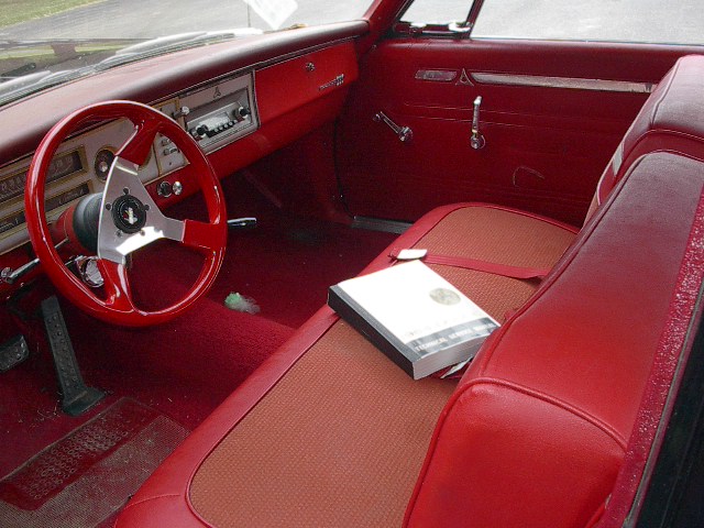

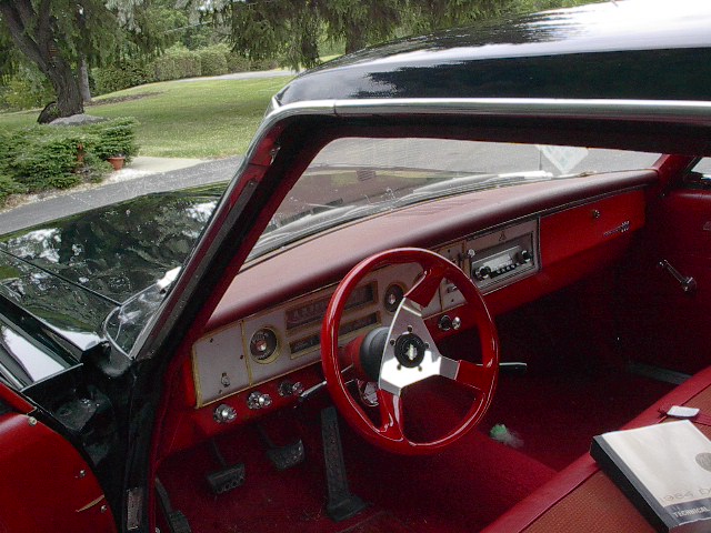

The best way to describe it is the flat stock is two inches longer than the seat track when it is attached with the holes located positioning the tracks back 2 to 3 inches. The flat stock was a 1/4 inch thick 1 inch wide the track is stronger than the stock piece so the seat will not rock back. and the seat belts fit fine. The picture is the best I can do since I sold that car but you can tell the room from seat to IP.IM001658.JPG
oh ya, I can definitely see a difference in the seat position.
still not able to visualize the actual seat track and welded bar orientation.

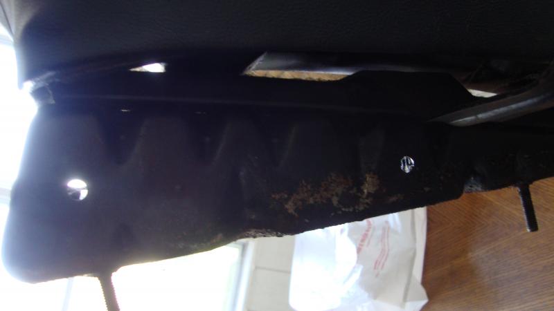

ok, so I took a look at the seat track and think I know what you're talkin bout, Black.
you actually take the triangular piece (that bolts to floor) that is riveted to the seat track itself and weld flat stock to the track. then rivet or bolt the track back to the triangular piece. am I close?
Google "seat relocation brackets" maybe some of them will work for you.
I put the flat stock between the floor and the seat track. The piece in your picture(seat riser) with the studs is what I welded the flat stock to then bolted the whole assembly to the floor. The studs on the riser would come out and they would now be on the flat stock to bolt to the floor.
Ah! I get it now! :headbang:
Did you buy new bolts? It doesn't look like they can be re-used
Yes bought new bolts and nuts/washers grade 8. You can weld in the bolt to the riser or what I did just a clearance holes and bolt and nut.

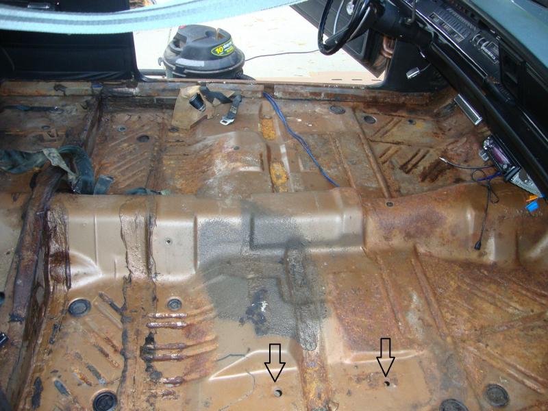

I did take a look underneath and there are cross members where the bolts go thru now, and if I were to drill holes and weld supports, etc, the cross members would interfere to the point where I would have to chop them back thereby weakening the entire floorboard.
I may do a version of what you did, Bruce. Just cut the damn bolts off the tracks and re-weld them further forward and that will push the seat back by an inch and half or so.
