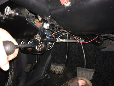

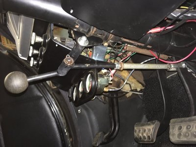

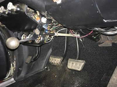

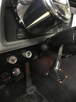

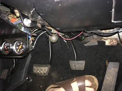

A few months back I seen this old school ad for a Blair race/drag brake I believe Ansen built one as well and probably many others. it was basically the roll control before hurst came in with the button. I figured I'd try to build one for the old Plymouth.i already had an adjustable proportioning valve so that was easy .After some measurements and a few attempts it's all done and looks pretty good in my opinion ...excuse the mess under the dash got some cleaning up to do there
