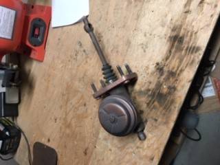

Finally got this thing off. What a pain. Any tips for installing the new one (other than do it before the dash and everything is installed)??

I would recommend you upgrade that MC to the dual for safety, many here will agree. The only reason to keep that style is if your going concourse resto....IMO
Take the driver's seat out, pad the floor near the door opening threshold so you can lay on your back and not dislocate your vertebra.
It's worth the little bit of time.
You are going to need a socket, swivel and extension and some flexibility in you upper torso lol. Put the mc in and get the pushrod bolt started to hold it. The lower two nuts are easy, the upper two need the swivel and extension. Stick the nut in the socket with some pipe dope so it doesn't fall out and disappear behind the carpet.
And I've been running a single reservoir mc on my 62 for years. Keep it maintained and make sure the emergency brake is adjusted correctly.

Yes dual reservoir is going in for sure. I upgraded to discs in the front as well.

Thanks! I didn't think of using the pipe dope. I'm probably one of the least flexible people out there, lol

I find a small length of electrical tape across the socket with the nut/bolt stuffed into the socket will retain the hardware without any mess. Put the sticky side of the tape into the socket. The same tape will work to limit/stiffen the flex in a wobble socket when you don't want the socket to be too "flexible". Just put a wrap around the "u-joint" area of the socket.
Mike
I've found Stanley brand "medium" depth sockets work very well for the brake pedal area.
There are some places where a shallow socket will not clear the stud and a deep socket will get hung up on the bracing.
I tape my u-joint some so it doesn't flop around and a 12" extension. 493 mike meant same ?
I tack welded some bolts from the inside, while the dash was out. That way, it's held on with nuts from the front.

I just went through the sort of deal recently.. I'm 73 with a bad back and other old age challenges. My car is a 62 with a 6 point cage and no one to help. Lots of sharp pointy things down under there too numerous to mention. I padded the floor with pillows and blankets to even the hump out a bit. I went in from the passenger side. My advice is to phone Dr. Diff to get his advice for the correct MC with a adjustable push rod. There are too many variations for the average guy to sort out without wasting money and time. And time squirming in and around under the dash for me was Painful, ,,,,
Lately I've been using one of those folding mini-scaffold things, up on a few 4x4's getting it as close to level with the door sil as I can, and putting a couple layers of towels over the gap.
