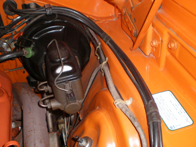

You will also find the 70 disc brake cylinder has the lines on the engine side of the resorvior.
Superbird may be a wildcard for this but normally '70 B power disc cars with wedge had brake lines on driver side. Believe the hemi cars were on engine side & this was the difference between the 2 MC part #'s, both had 1-1/8" cylinders.

All Hemi master cylinders lines exited the fender side !

You are correct on that, my error. Did some further research in my parts books & original P/N's are 2944476 (hemi) & 2944477 (wedge). Pics of NOS parts show hemi had outboard fittings & wedge inboard. My survivor '70 exits on outboard, has 100% untouched brake lines although I replaced the old MC some 20 years ago. Maybe some midyear change? Different plant variation? Who knows?

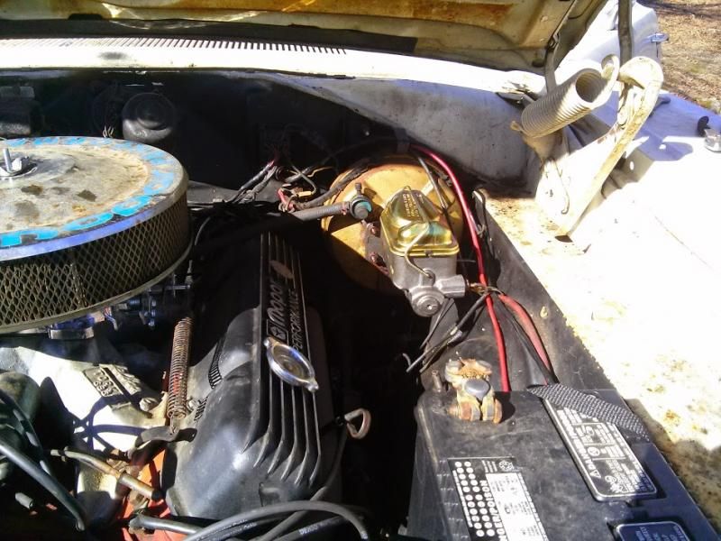

It actually DOES matter if the lines are on the engine side vs. fender side -- the engine sides lines were recalled because they were too close to the exhaust manifolds -- and FAILED miserably when they got too hot (vapor lock scenario)....
The master cylinder that the one guy has illustrated is INCORRECT -- that is the 1971 - 1973 Master Cylinder --- works in a pinch -- but you will have only 60 % braking rather than 100%...
