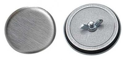

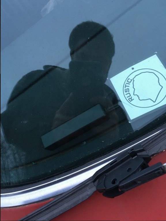

Mr belvedere here again to share one of my little proud moments. Some time ago I installed a aftermarket Alpine stereo and in doing so also removed my wobbly old antenna and replaced it with a dash mounted antenna that literally is just a little 2.5" black rectangle that now serves as my am fm antenna, a beautiful thing, yes? That left me with one problem. The fender now had I big ol hole where my antenna once was. It occurred to me as I stared blankly at this new hole that it was just about the size of the hole that a faucet goes into in a stainless kitchen sink. My solution? I used the little plastic chrome sprayer mute for when a faucet doesn't come with a sprayer!
It has a nice little foam rubber gasket on the bottom and was a perfect fit! I reached under the wheel well to tighten the nut and never looked back! The thing cost under 5beans from the Deepts! One of my prouder moments indeed..

I have had pretty decent reception all around, and it just sits atop the dash hidden up in the corner near the windshield on the passenger side. I like it quite a lot! I haven't noticed any difference in reception from my old outside one. I'll post a couple pics of both the hole cover and the antenna tomorrow for ya

I had thought up inside under the dash.. but, all that metal surrounding it would probably cut the signal down Does yours antenna have the "signal booster" that you run electricity to?......................MO

Not too sure I can't remember but I got the one from summit I think I'll look at it tonight to see if I can tell

I ran the wire up and out of the vent which I have nothing connected to, actually, but that's how I did it. And I think this one from Summit is the one I have and if not it's pretty much the same.
