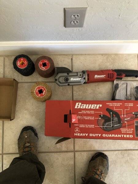

Can you get replacement sanding drums for it , thinking about getting one . Thanks
I already did from Amazon! They take the same as Eastwoods as its the same unit! I got the paint stripper crud wheel for $25 to my door in 24 hrs. Eastwood wants $50 for the same drum…just sayin
The new Harbor Freight thing is awesome and I was gonna suggest it. I did a video on youtube showing it on one of my cars, strips the paint super quick!

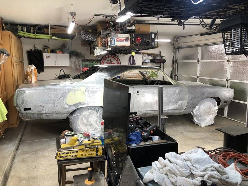

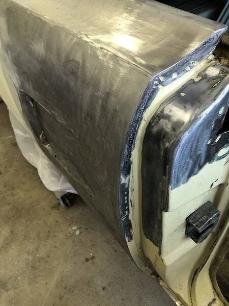

Going inch by inch. Almost done exterior. Interior is a pita lol. Using everything wire wheels flap discs drums …. When I get tired I stop as its a lot of physical work add the PPE and its a slog but I am just about there. Epoxy soon!
Hey guys what is your tip tricks tools etc. on removing paint from area’s that aren’t flat or that have a lot of mechanical details? For example see my shot below. Sandblasting not an option. I used Aircraft stripper in the 70’s and that stuff was good. Tried a few years ago and it looks like it had been neutered….
Also I have to do the floor which is very 3D.

Yup I think I might have mentioned it previously. I have a hydroblast set up and it works great BUT all that sand inside the doors and crevices is problematic. Also I can’t move the car out of my garage for several reasons. But it keeps crossing my mind as I struggle to complete this task with mechanical abrasives. I am almost done too.

Yeah I agree if I could rotisserie I would and it is more work and less effective no doubt. However we all live with limitations in life….
