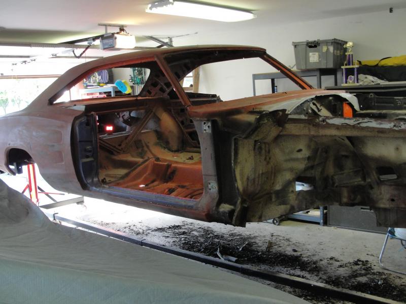

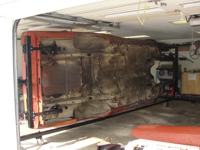

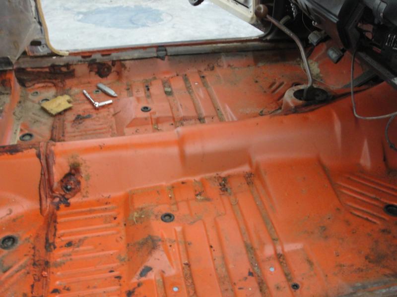

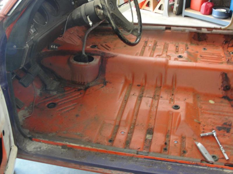

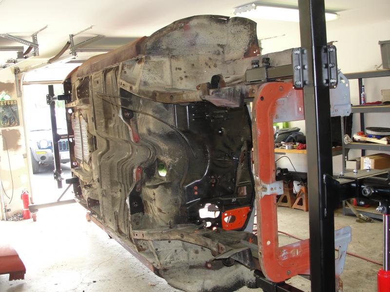

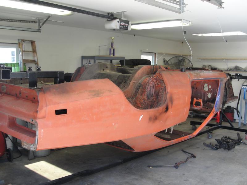

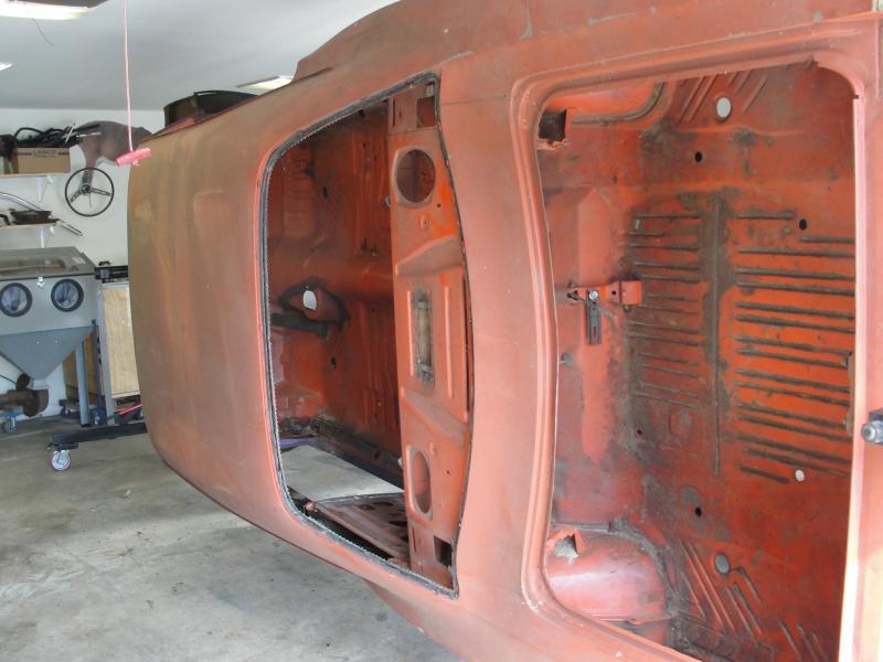

So it looks like I'm going to media blast my Superbee. I thought about selling it and thank god I didn't. So I met wih the painter today. He wants it stripped down to metal I plan on doing the entire exterior, but not the interior floors.
My question is - What media do I need to request? Attached are pics of the Bee

Your Media Blaster 'should' know what to use, tell him to not warp anything, see if he's done more cars before yours...i.e. pictures? Looks like a nice car! Might as well do the entire car inside and out. You have a rotisserie, does your blaster guy have one too? I use soft blasting media all the time, sometimes I need to use something harder (never sand) for removing chrome, etc.

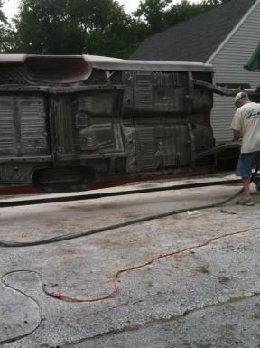

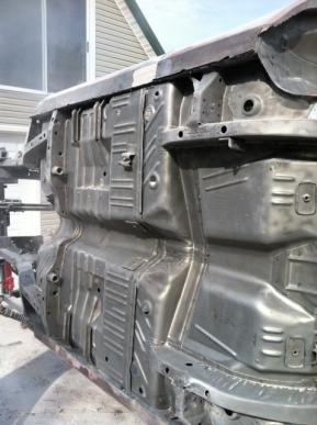

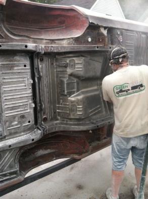

Well,, This is what I got done today...

I can take a stab at answering those questions! Price and 'fair' is all relative. However, do you want to do follow-on work after your blaster does his job? Meaning, what I see in this pic is a guy Soda blasting the floors. Yes, its clean, but, its too smooth for paint adhesion, and, rust activity is still active. When you cook a steak, you want the flavor inside, not just brushed on the outside right? So, what do you do? You tenderize the meat, punch it a bit...then, flavor it. Media blasting 'should' be the same way, punch that metal, find the weak areas, use soft media, use lots of cfm, low air pressure -- this way you mitigate all chances for warping/damaging panels. Then, put the epoxy primer on, on top of the slightly profiled surface.

I paid $1675 to have the entire car in the photos above soda blasted. It took 13 hours. http://www.gcmobilesodablasting.com/ . These guys did every nook and cranny. My next step will be to power wash every nook and cranny and hole with http://holdtight102.com/ . I'm very very please with the finished (stripped product). No surprises and super clean. Nice layer of dust left on it to prevent flash rust.
PS - And did it in my driveway.. Hosed off the garage doors and mother nature took care of the rest on the driveway today. Nice rain... poof gone.
