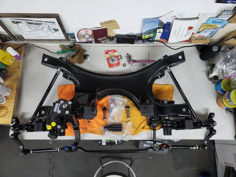

When I worked over the k that goes into my 65, I had it tanked twice and there was still crud hiding in there that showed up when I was doing my mass welding. I ended up getting the Victor Wrench out to burn the remainder from the back areas and crevices.
Ya, the only way to really get it clean would be to cut all the oem spot welds, and disassemble it completely. Though without building a jig, that would be pretty dicey getting it back together properly. This will be better than stock, it's just not pretty.
I left my oe welds intact. Just added about 120+ more along with quite a bit of additional reinforcing.

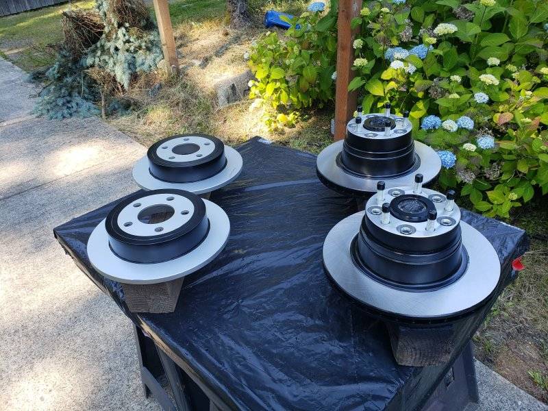

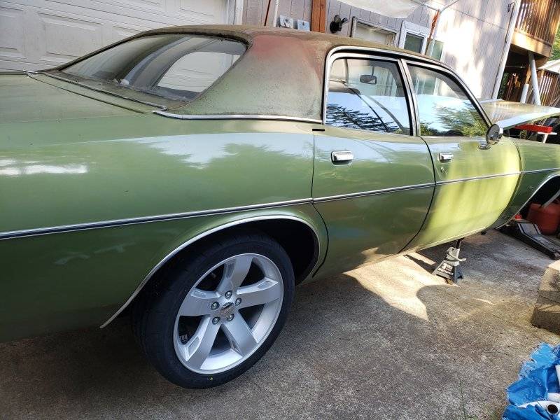

Ok, since our last episode, I've finished the k member and assembled the steering box/idler/lower arms/ball joints/strut rods and got it put under the car (with some help... that thing is heavy). Also couldn't help myself and stuck the adapters and rear wheels on. They'll probably be controversial, but I like them and that's what counts.

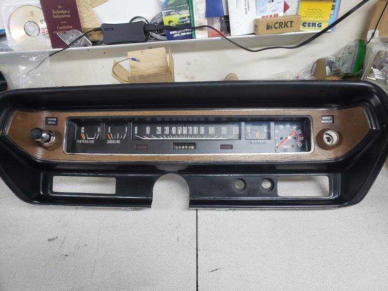

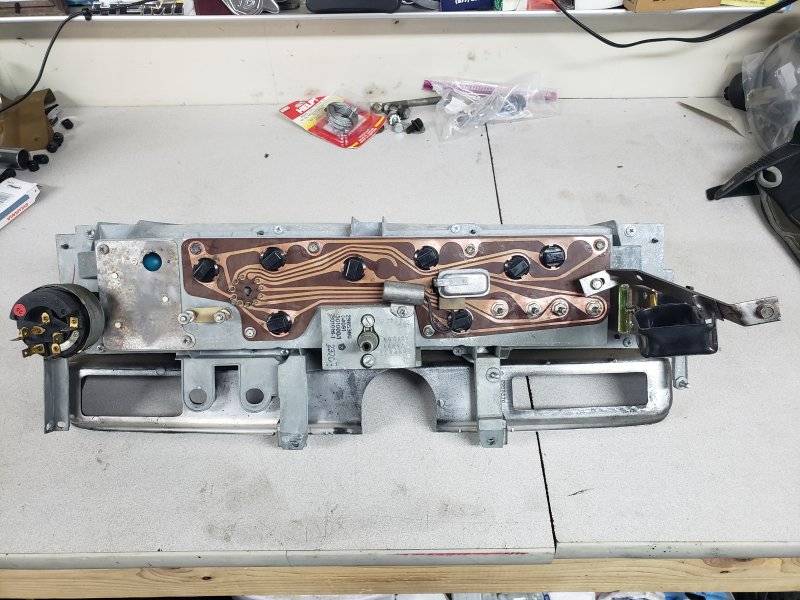

Been knocking out prep jobs and such before I get further into reassembling suspension. Finished removing the old torsion bars (so small compared to the new ones), cleaned and painted the new front/rear brake rotors, cleaned all the connections on the instrument cluster and replaced all the bulbs, cleaned and painted the lower steering column. Next up is some rust correction under the dash, and getting the torsion bars in place, a job I'm not looking forward to,

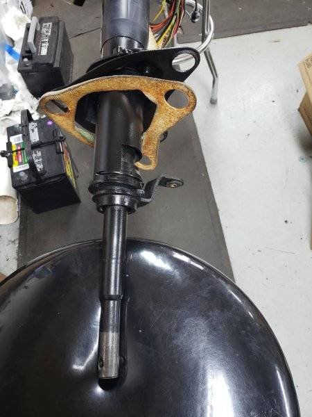

Anyone know what's supposed to be here?? Bushing? It's a tilt column, not original to the car per the fender tag. The tilt columns don't seem to have much info available other than they were GM built. I really want to go with a different steering wheel too, but again, I can't seem to find any definitive info on what adapter actually fits the tilt column.

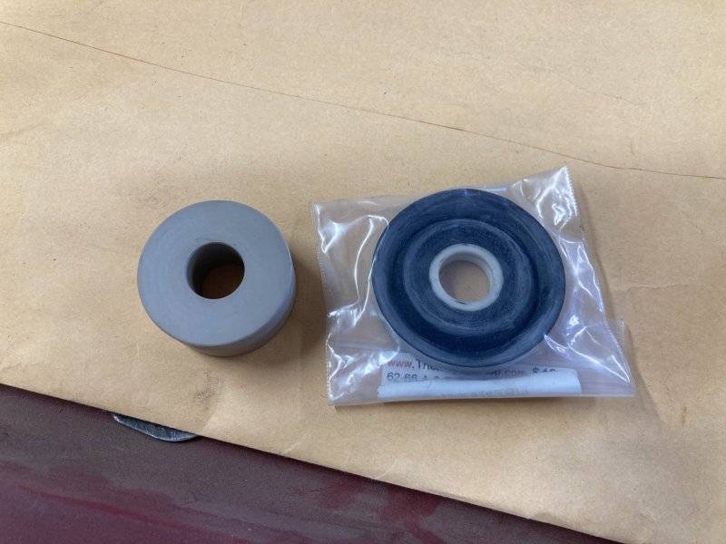

For my 65, I had a guy make a Delrin bushing for that area. From the factory, they use a boot/bushing but I wanted something better. There is of course a bearing up top. The bushing isn't installed yet, thats down the road when I put the BAC coupler in with the new internals.
Ya, I was thinking of making something similar, though maybe from some bearing bronze I have a stick of.

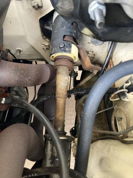

While I was rechecking valve cover bolts on my 67 wagon, I saw this. Most likely what you are missing. The bushing will probably be easier though. Non tilt column BTW.

Mine is similar, but different. Here's a pic of mine from a similar angle. The shift arm is reversed on mine, and the end of the tube is different. The bushing is probably not a lot different, but definitely attaches differently.

Thanks, that's awesome... I'll check the dimensions to be sure they're the same as my setup, but if they are that's great!
Had a chance to check the dimensions on that particular bearing and the OD is too large for my column. Some more digging found some that may work, it might just be simpler to make a plain bearing out of delrin/bearing bronze though. Will be giving it some thought while I'm relaxing in Victoria, BC over the weekend.

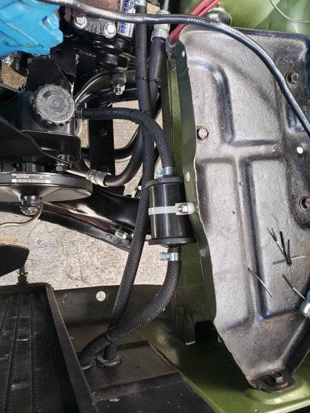

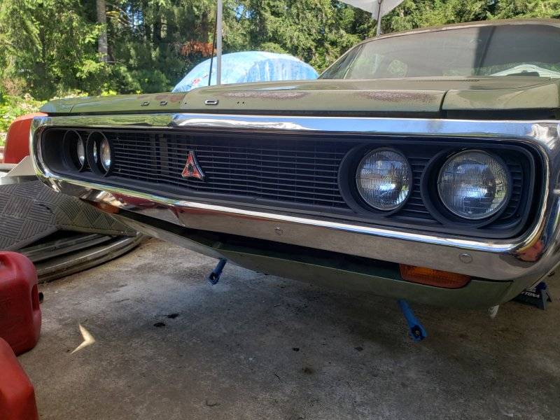

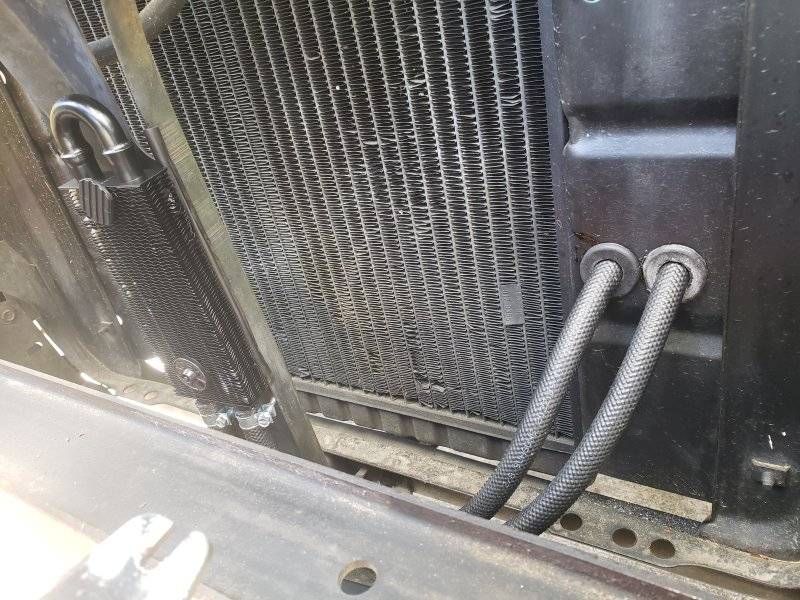

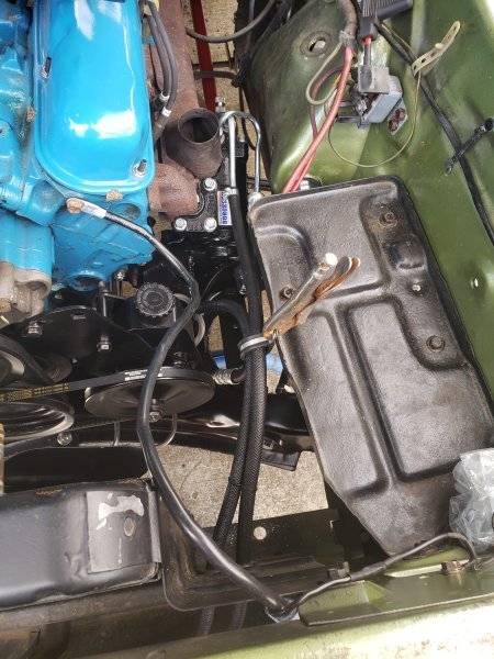

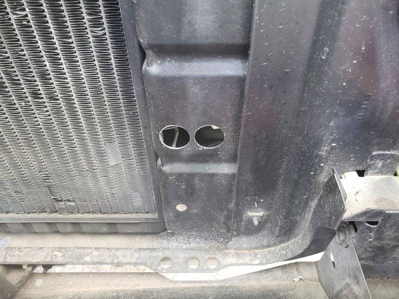

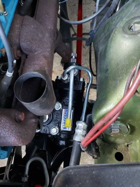

Ok so the last few days I've gotten some more stuff done. I mounted up the new PS pump, ran the lines, and added the Borgeson recommended PS cooler. Pulled the grille out so I can 1) Put in better headlights (Hella E-codes with relays/new wiring, waiting on shipping), and 2) I can repaint it. Never really liked the silver grille, and I've seen several Coronets with black grilles and much like the difference between a Satellite and a GTX... the black grille looks better. So that's what I did.
Ok, grille back in... love it. I'll get a better shot when the car is movable, but it's quite a difference. The removed bumper guards help too. Much less "old man car" than before (ya, ya, I know I am one... shhhhhh).
Before and after...

Wow, been a while... so in the off time I've taken the car to a bunch of shows, joined a local Mopar club, and sanded down and epoxied the roof. Since buying the Satellite I've decided it's the better place to put the GenIII hemi, and purchased a wrecked '98 Ram pickup which is donating its engine/transmission to the Coronet. I'm currently freshening up the 5.2 Magnum and doing a few mods (Hughes intake/cam at this point), and have the parts to rebuild the rear axle with a limited slip and 3.55 gears to take advantage of the OD 4th gear in the transmission.

Consider taking a silver Sharpie and highlighting the edges of your grill fins. You have the silver front with the flat black background. I've also seen red that looked good, but on yours, I don't think red would fit. Maybe another color?? The all-black grill looks somewhat dull. Just sayin'.
